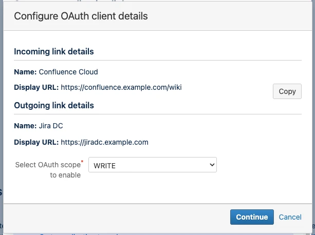

  5. In the Review link screen, confirm the details and select Continue.
  6. Select the permission scope that is required for the link request.
Configure OAuth client details

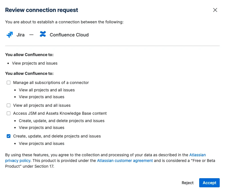

  4. Find the link request from your cloud instance, then select Review request.
Review connection request
5. Review the scopes requested by the incoming link. Make sure the scopes accepted in Data Center match the scopes requested on the cloud side, then select Accept. Your Confluence Cloud and the Data Center instance are now connected.
