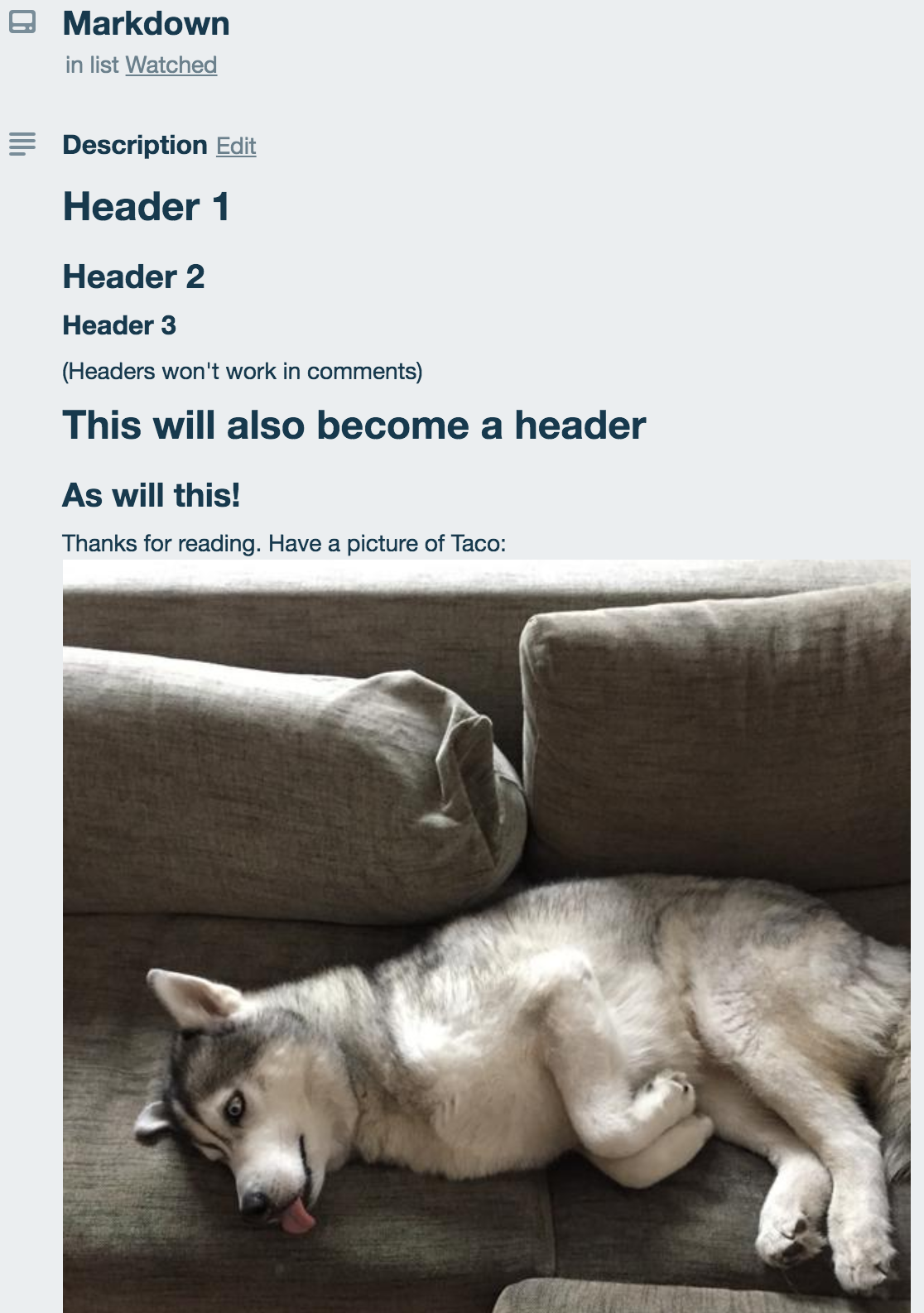

Headers - Headers can be marked in several ways. Text in #Single Hashes# will be interpreted like an `<h1>` HTML tag (a big header). Text in ##Double Hashes## will be interpreted like an `<h2>` HTML tag (a smaller header). In headers, a line of hyphens below text will also be interpreted as an `<h2>` tag.
Syntax that only works in card descriptions:
Embedded images - Embed an image by putting the link text in brackets and the image URL or path in parentheses, prefaced with an exclamation mark, like: ![Alt text](/path/to/img.jpg).

Escaping Markdown  - To use the markdown syntax literally, you can escape the formatting using a backslash '\' before the symbols, e.g. \*literal asterisks\*.
