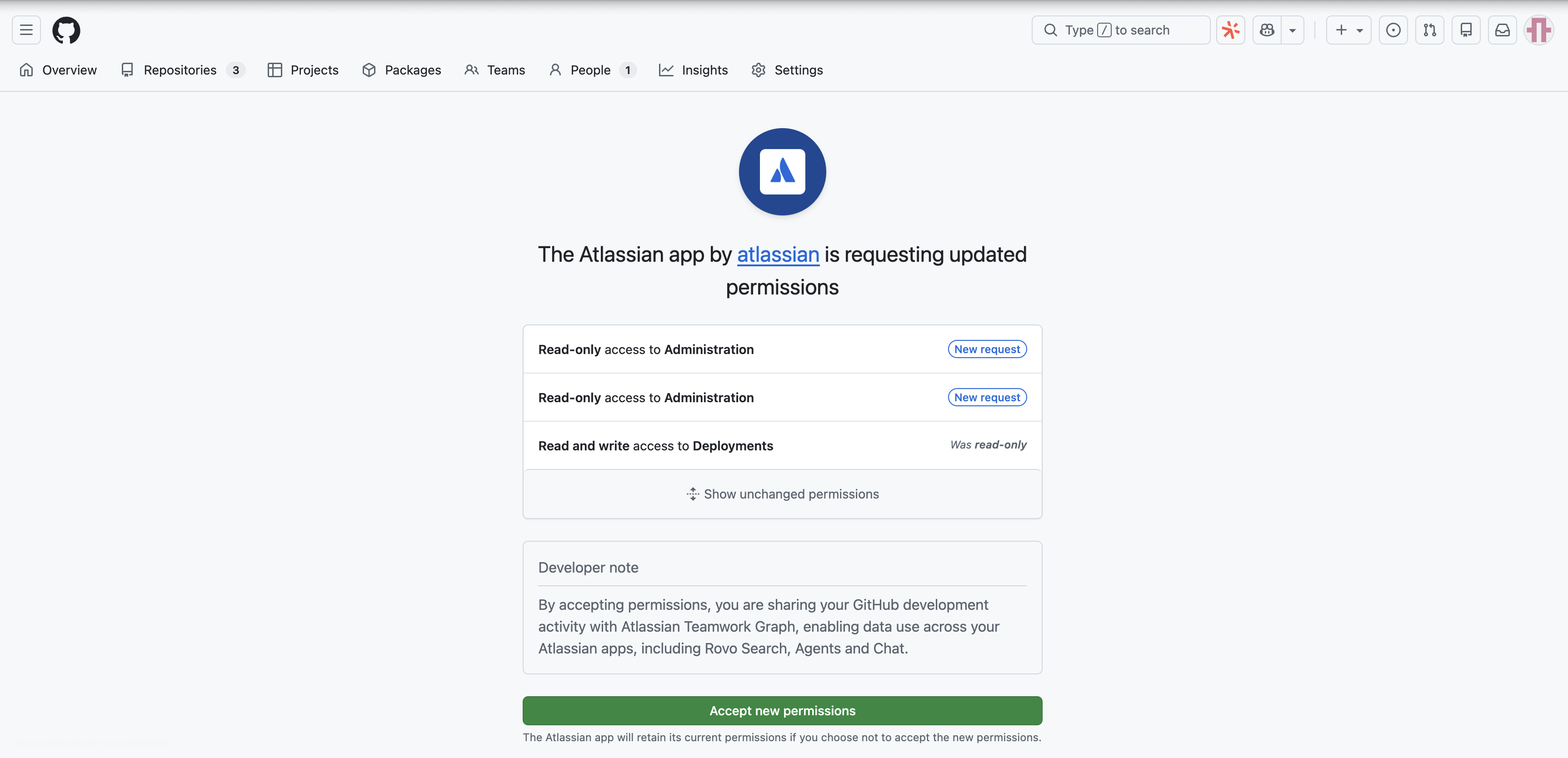

Step 2: Accept the updated app permissions in GitHub
If your permissions are showing as Limited, a GitHub organization owner needs to accept the updated permissions:
  1. Sign in to GitHub as an organization owner.
  2. Open the GitHub for Atlassian app installation for the affected organization.
  3. GitHub will show a permission update prompt. Review and accept updated permission scopes by selecting Accept new permissions.
