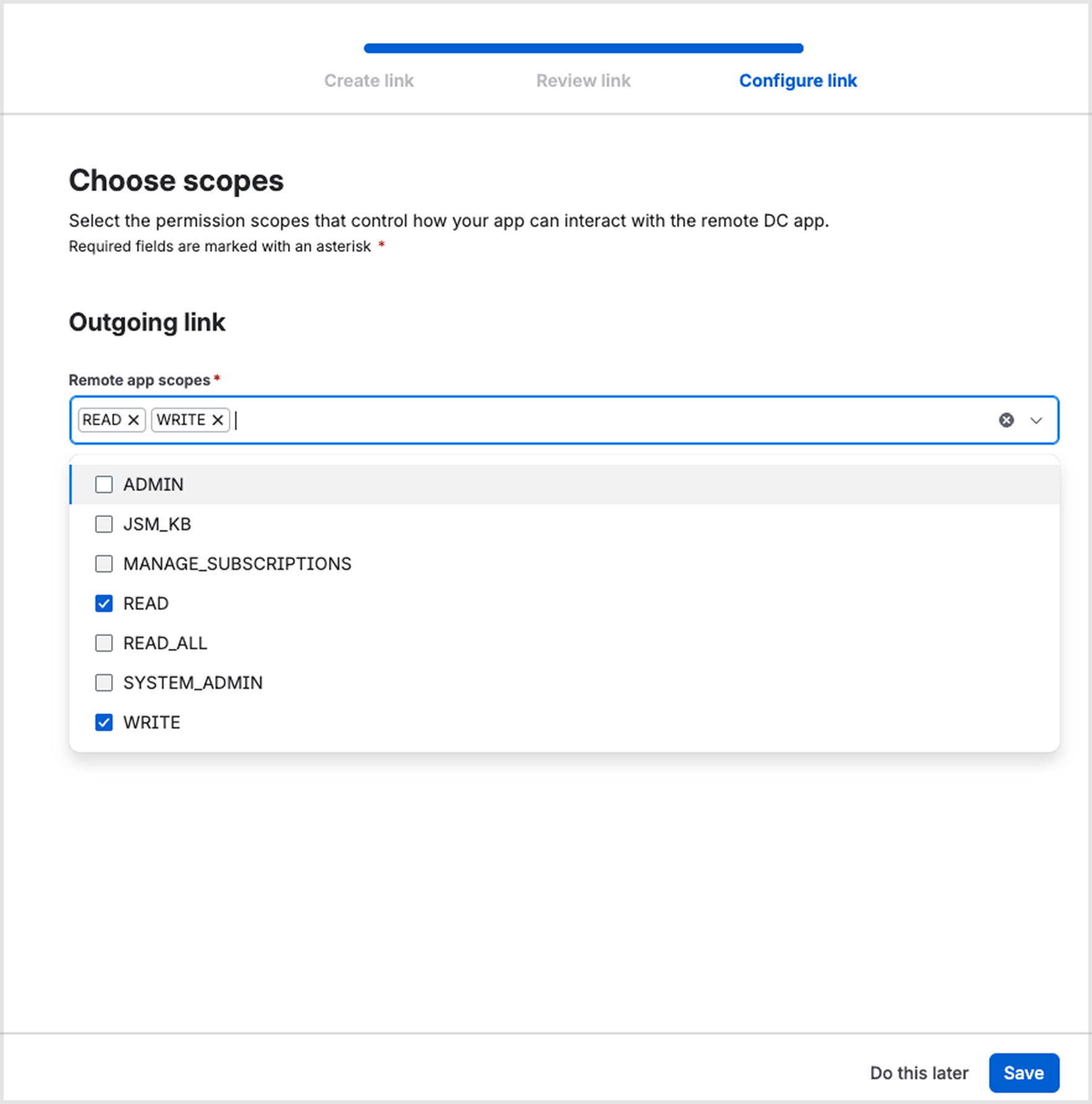

  6. Select the permission scopes that are required for the application links request.
Choose Scopes screen

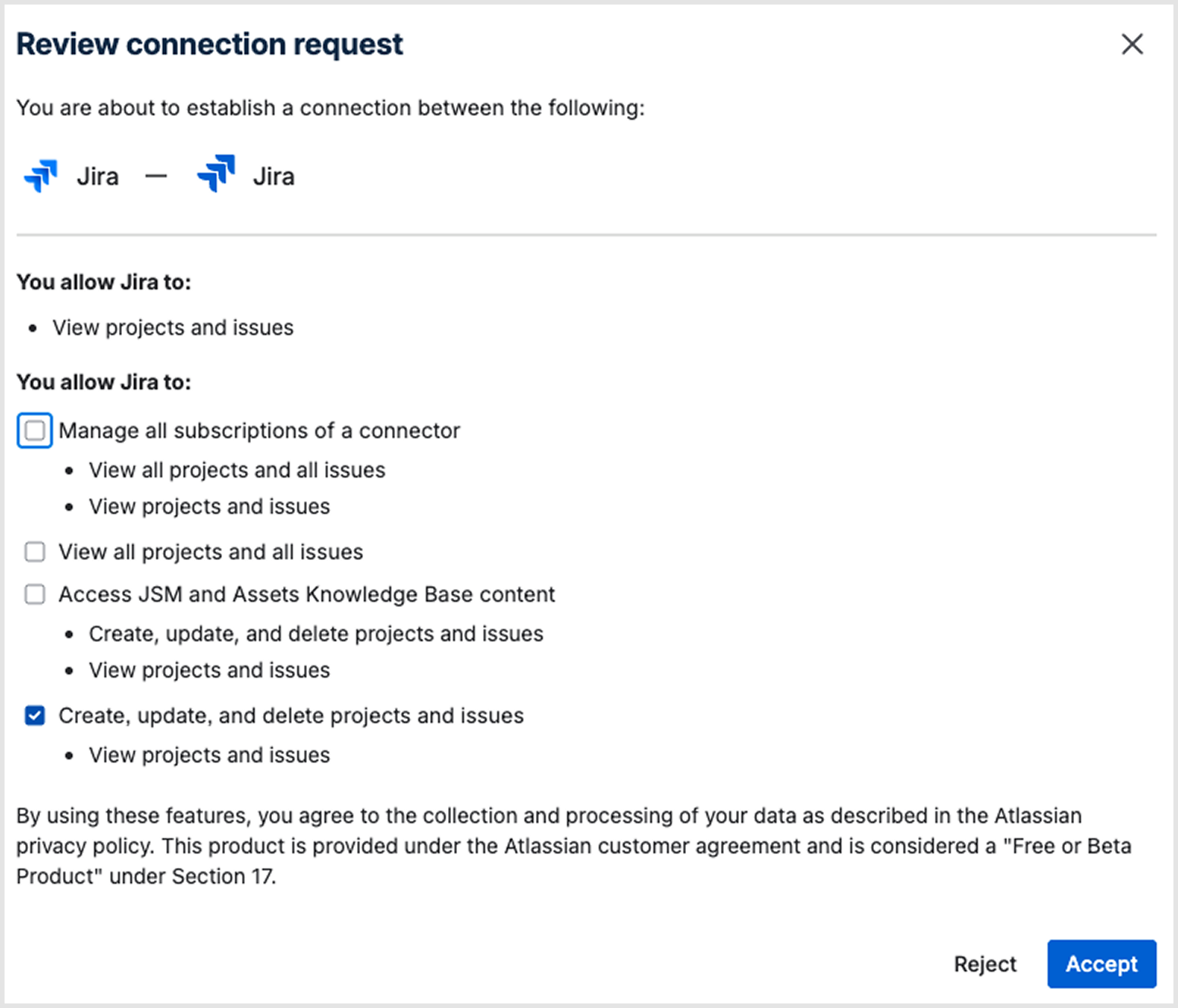

  4. Find the link request from your cloud instance, then select Review request.
Review connection request screen
5. Review the scopes requested by the incoming link. Make sure the scopes accepted in Data Center match the scopes requested on the cloud side, then select Accept. Your Jira Cloud and the Data Center instance are now connected.
