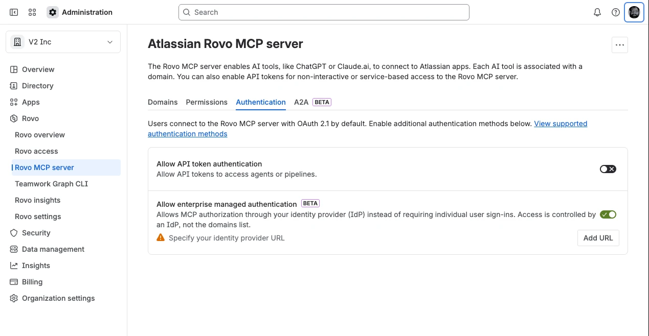

A2. Enable enterprise-managed authentication in Atlassian Administration
  1. Go to Atlassian Administration. Select your organization if you have more than one.
  2. Select Connectors, then Atlassian MCP server.
  3. Select the Authentication tab.
  4. Turn on Allow enterprise managed authentication.

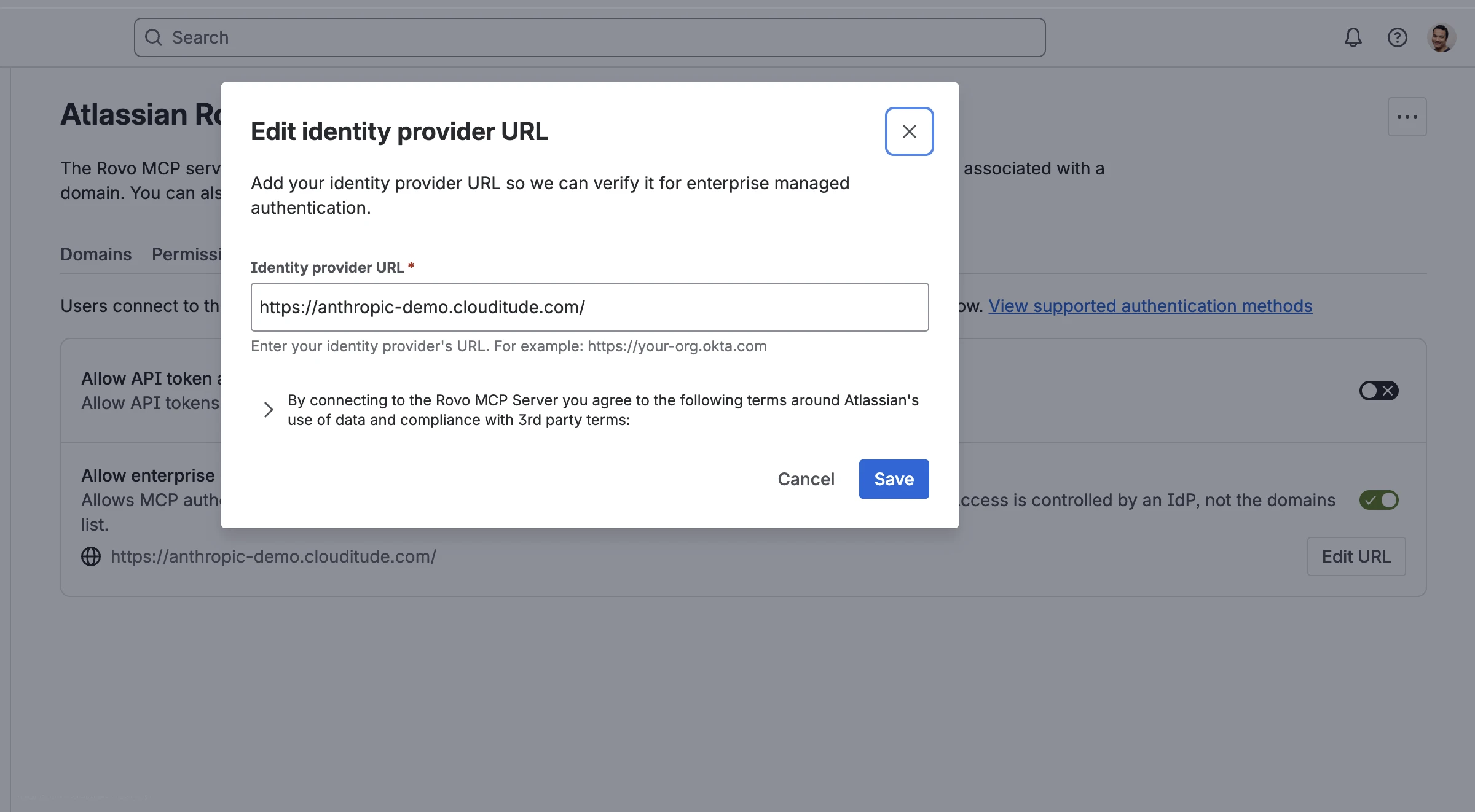

  5. Select Add URL (or Edit URL if a URL is already set) and enter your trusted identity provider URL. For this option, that's the Issuer URL you copied in A1.
Authentication tab in Atlassian Administration with enterprise managed authentication turned on.png
Edit identity provider URL dialog in Atlassian Administration

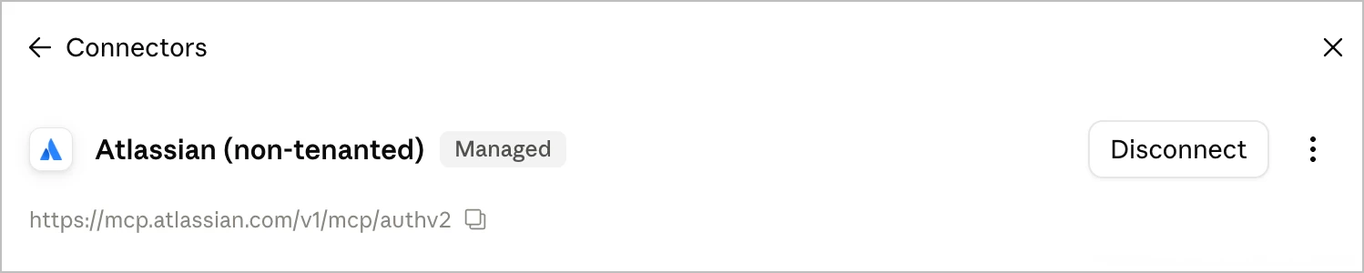

A3. Test and enable in Claude Admin
  1. Return to Claude Admin and select Run test. Make sure every step passes.
  2. Select Continue.
  3. Under Roles, choose who connects through managed authorization, then select Enable.
  4. You can now start using the connector in Claude. If you need to add it manually, use the MCP URL from step 1b.
Claude Admin role selection for managed authorization
Atlassian MCP connector configuration in Claude Admin with managed authorization on
You're all set! Once connected, your users can access Atlassian tools through Claude without signing in to Atlassian individually.

  5. Select Add URL (or Edit URL if a URL is already set) and enter your trusted identity provider URL. For this option, that's your Okta tenant URL, for example https://your-org.okta.com/.
You can find your Okta tenant URL in your Okta Admin console. It usually looks like https://<your-org>.okta.com.

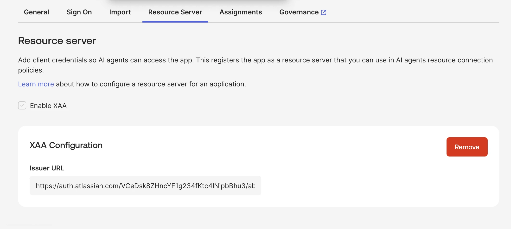

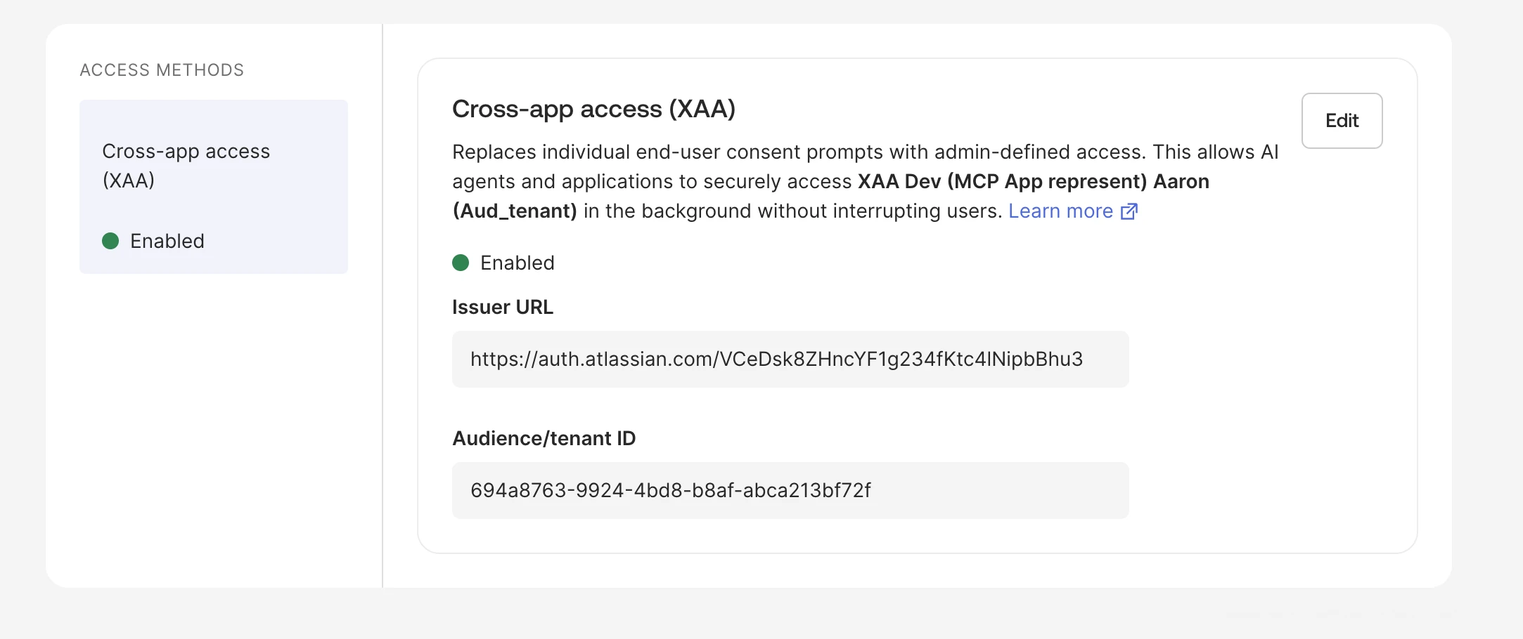

B2. Add Atlassian details to Okta
Now add the Atlassian details to your Okta XAA Resource application.
  1. In your Okta Admin console, open the XAA Resource application you created during the Okta setup steps.
  2. Enter the Auth Server URL from step 1b in the Issuer URL field.
  3. Enter the cloudId from step 1a in the Audience/tenant ID field.
  4. Save your changes.
Okta cross-app access settings with Issuer URL and Audience tenant ID

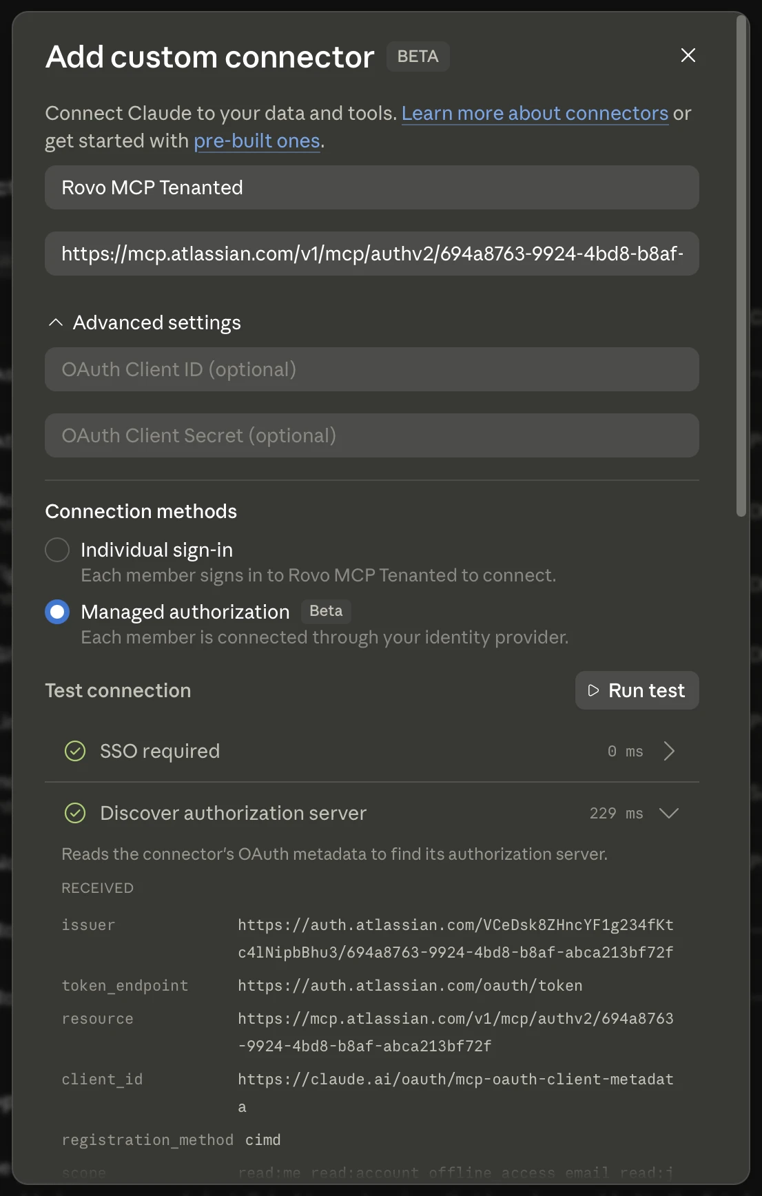

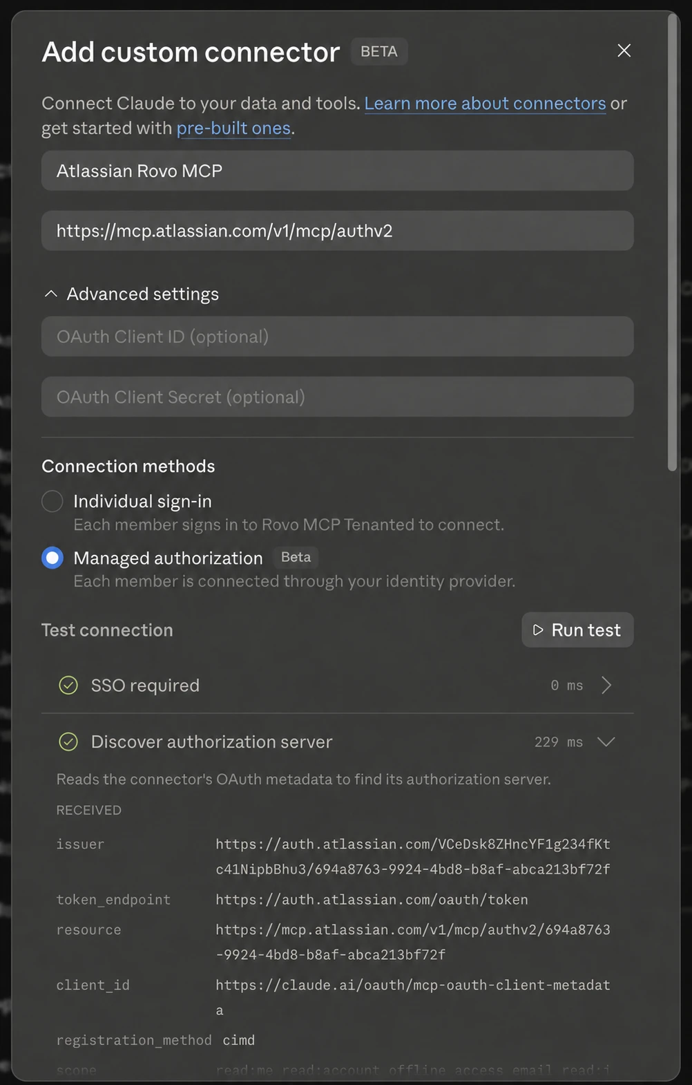

B3. Connect Claude to Atlassian through MCP
The final step is to configure Claude with your Atlassian MCP connection.
  1. In Claude, open your MCP server settings and add a new server.
  2. Enter the MCP URL from step 1b.
  3. Set the connection method to Managed authorization.
  4. Save and connect.
Claude custom connector with the MCP URL and Managed authorization selected
You're all set! Once connected, your users can authenticate with their Okta credentials to access Atlassian tools through Claude.
