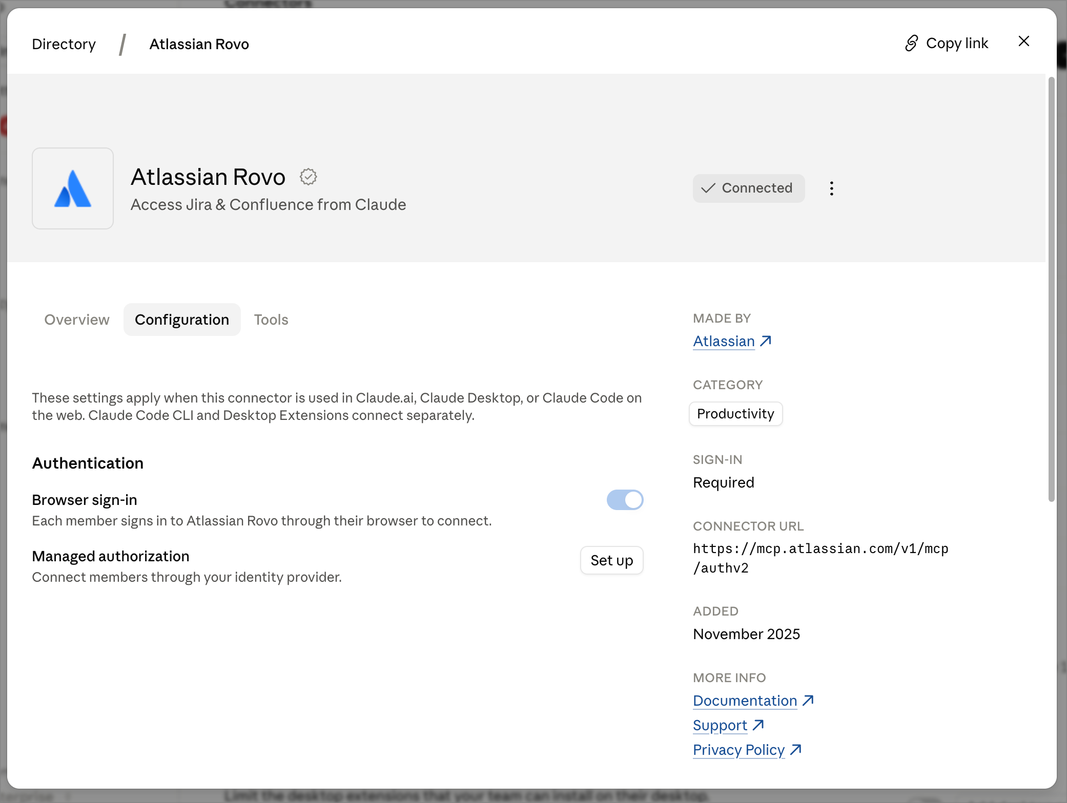

  1. In Claude Admin, go to Connectors.
  2. Add the Atlassian MCP connector if it isn't already added.
  3. Select Enable auto sign-in.
  4. Select Atlassian MCP.
  5. Under Identity source, select Claude-issued.
  6. Copy the Issuer URL. You'll add it to Atlassian Administration in A2.
  7. Enter the cloudId from step 1a in the Tenant ID field. This step is required for the integration to work.

  1. In Claude, open your MCP server settings and add a new server.
  2. Enter the MCP URL from step 1b.
  3. Set the connection method to Managed authorization.
  4. Save and connect.
Claude custom connector with the MCP URL and Managed authorization selected
