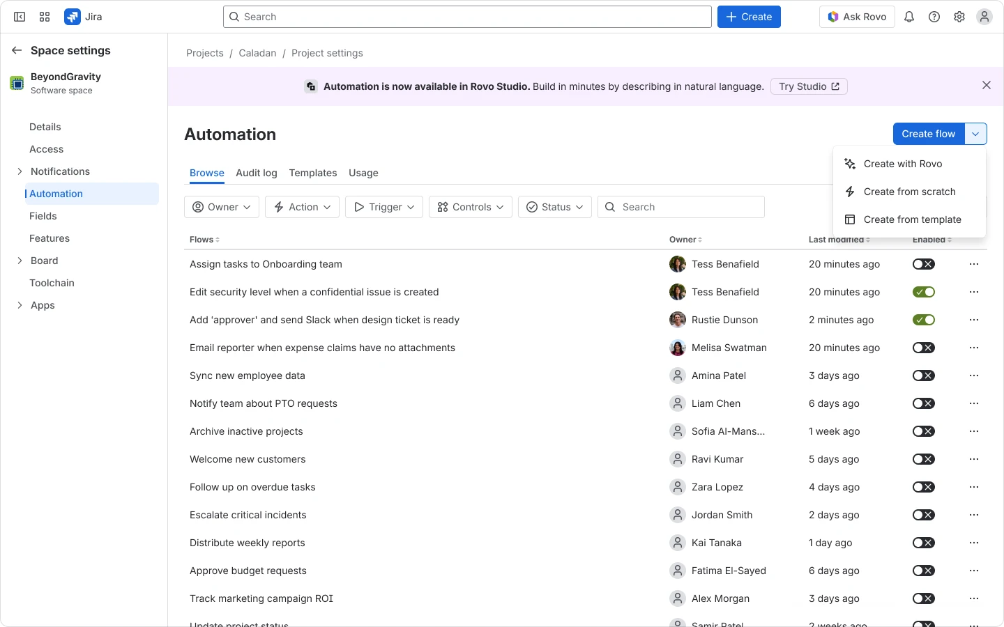

Create a flow from a template
Screenshot of the different templates you can use to create an automation rule
フローをテンプレートから作成するには
  1. From Jira, find the space you want to add a flow in the side navigation and select More actions (…) > Space settings.
  2. Select Automation from the side panel.
  3. Select the Create flow button in the top-right of automation. A dropdown will appear.
  4. [テンプレートを使用する] を選択します。
  5. Select a flow template.
  6. Optionally, rename the flow and edit the flow details.
  7. Use the flow summary on the left to make edits:
    1. Select each step in the flow chain to view and configure it.
    2. Select Add step to add more conditions, branches, or actions.
    3. Select Flow details to change the name and default functionality settings (like Owner and Actor).
  8. Leave the flow as a draft by selecting Close, or select Enable when it is ready to run.
