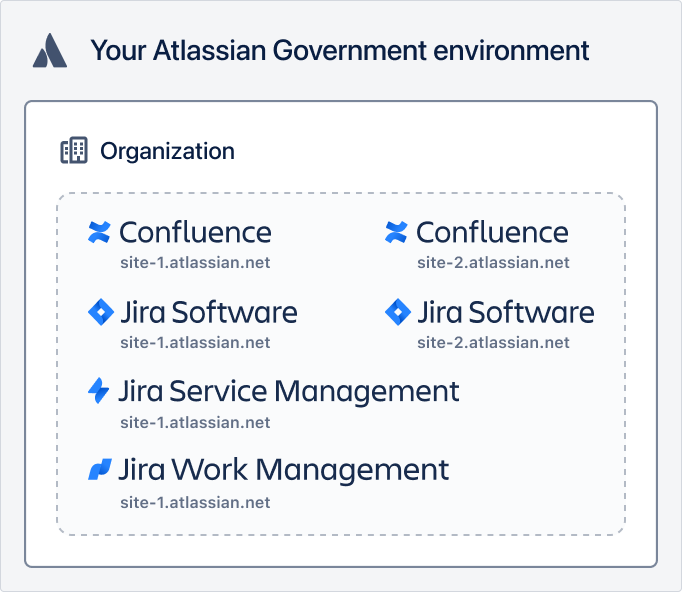

Organizations in Atlassian Government Cloud
Organizations in Atlassian Government Cloud work in a similar way. Your environment will have a high-level organization, with specific Atlassian apps inside. Similarly to Atlassian Cloud, every organization has a separate user base, including individual app access, user provisioning configuration, and so on.
Diagram showing Atlassian Government Cloud organizations
