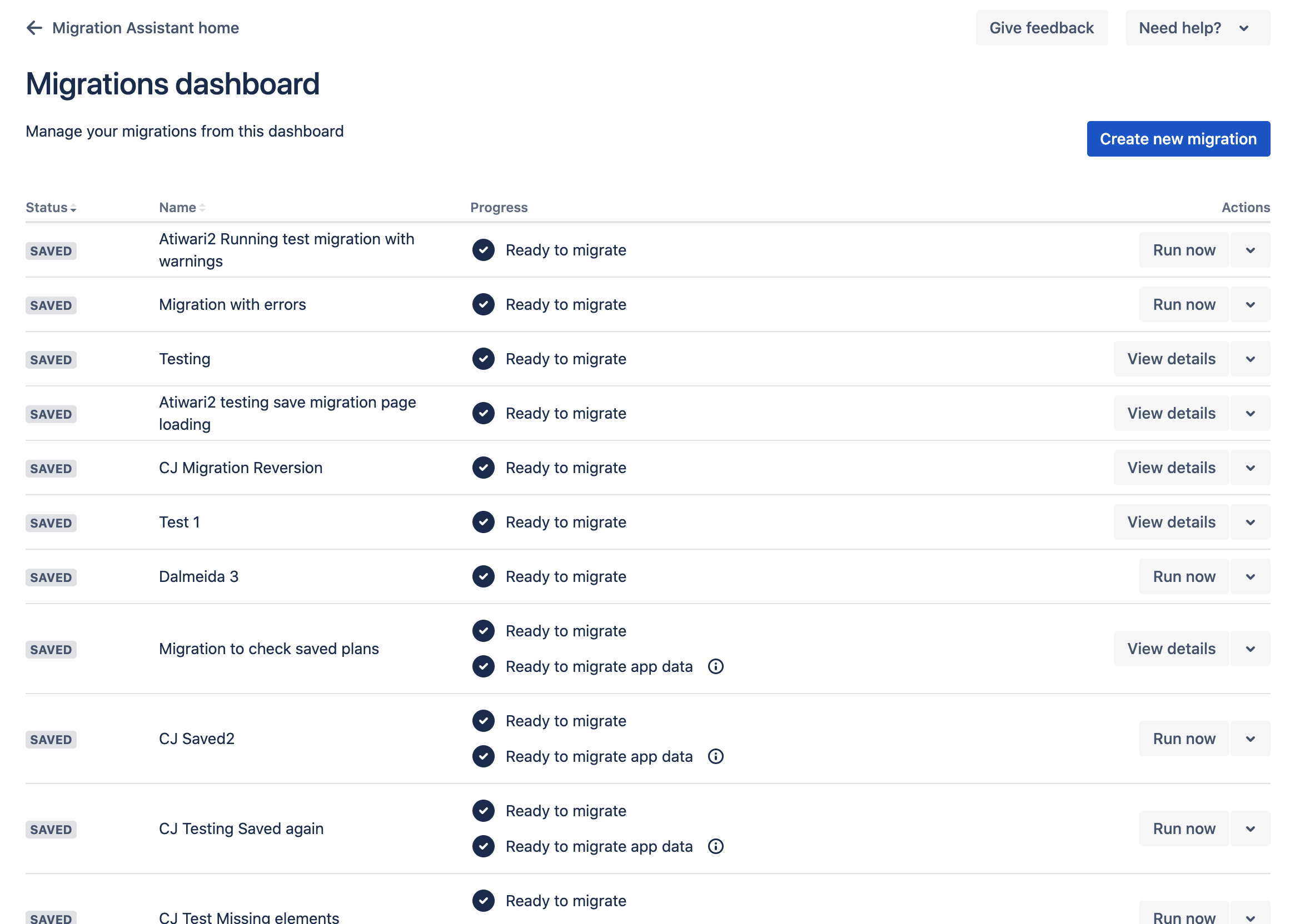

If you've any previously saved migrations:
From the migration dashboard, you can either create a new migration or run an existing migration. A message appears telling you to review your email domains.
Select Review domains to review all your email domains and mark them as trusted.
Select Continue without reviewing if you want to review your domains later. You can continue without trusting all the domains at this stage, but you won’t be able to run the migration.

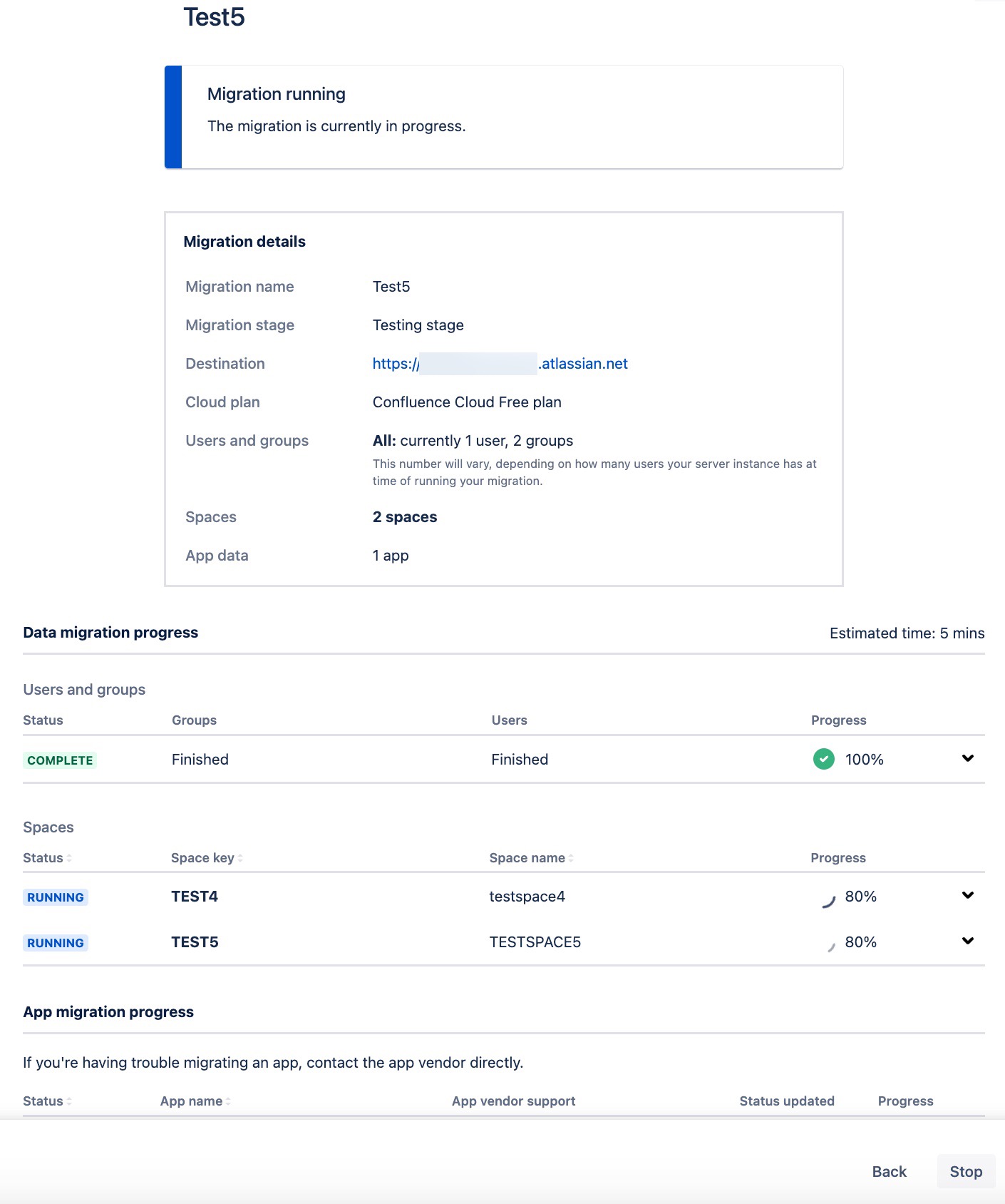

This is the final step in setting up your migration.
If everything looks correct and you want to start your migration, click Run. If you would like to start your migration later or you still have errors to fix, click Save. If you choose to run your migration, it will still be saved to your dashboard. There, you can view the progress and details of all your migrations.
Your saved migration will be listed on the migration dashboard, where you can view details or run it. You can also check the status of a migration, monitor the progress, stop a migration that's currently running, or create a new one.
You can create as many migrations as you need. At this time, migrations can't be edited or deleted, so if you create a migration that can't be used, just create a new one.
Status | Description |
SAVED | Your migration is saved and ready to run. |
RUNNING | Your migration is currently in progress. |
FINISHED | All tasks in your migration have been completed. |
STOPPED | Your migration has been manually stopped. Once stopped, it can't be resumed. Any step already in progress will first need to finish before the migration is shown as fully stopped. Some users, groups and spaces may already have been migrated to your Confluence Cloud site. |
INCOMPLETE | Some tasks were completed but there are some errors or some things that couldn’t be migrated. Importantly, this status means that some data (users, groups, spaces, etc) has been migrated and you may need to clear this data from your cloud site if you re-migrate the same projects. |
FAILED | We were unable to complete the migration. This might be because a chosen entity already exists in the destination site, or the migration hit an unexpected error. |
