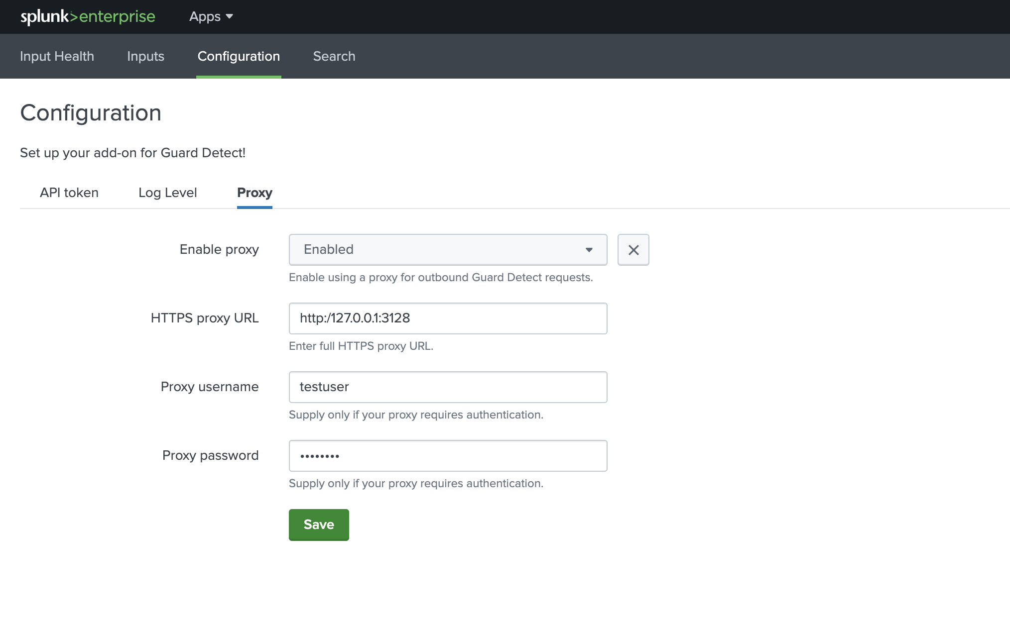

Step 3 (optional): Configure a proxy
If your Splunk deployment requires an outbound proxy, configure it in the Guard Detect Add-on:
  1. In Splunk, select Apps > Guard Detect Add-on for Splunk > Configuration > Proxy.
  2. Set Enable proxy to Enabled.
  3. Enter your HTTPS proxy URL (for example, https://proxy.example.com:3128).
  4. If your proxy requires authentication, enter a Proxy username and a Proxy password. Credentials are stored securely.
  5. Save. The add-on will now route outbound requests through this proxy.
Set up a proxy in Splunk configuration
