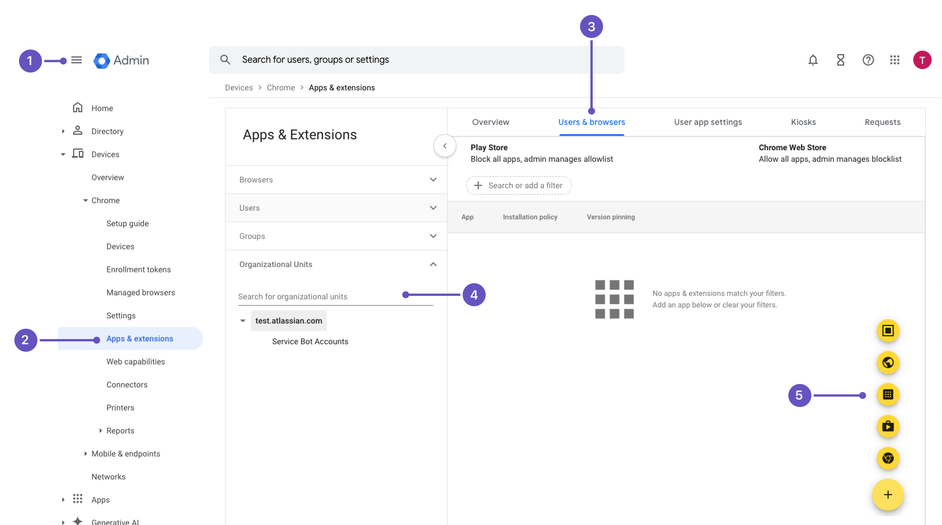

How to install
To automatically install the extension across your organization:
  1. Sign in with an administrator account to the Google Admin console.
  2. In the Menu, navigate to Devices > Chrome > Apps & Extensions. If you signed up for Chrome Browser Cloud Management, you’ll need to go to Chrome browser > Apps & extensions.
  3. At the top, select the Users & browsers tab.
  4. On the left, you can optionally select a child organizational unit or group to limit which users and browsers the extension will automatically install.
  5. Hover over the yellow plus (+) icon in the bottom right, and either:
  6. Select Add Chrome App or extension by ID and paste in the Rovo extension ID npbjhobkibekbklkghlhfhieggcggpdb and hit Save; or
  7. Select the Add from Chrome Web Store and add the Rovo extension.
Screenshot of navigation through the steps of Google Admin Console to add the extension
8. Once you’ve added Rovo, in the panel that opens on the right, under Installation policy, you can select between:
  • (recommended) Force install + pin to browser toolbar will give your users quick access to Chat from any page from the top right of their browser.
  • Force install if you prefer not to have the extension pinned.
Note: Both these options will stop the user from being able to disable the extension.
9. Select Save (or Override if you’ve selected an organizational unit).

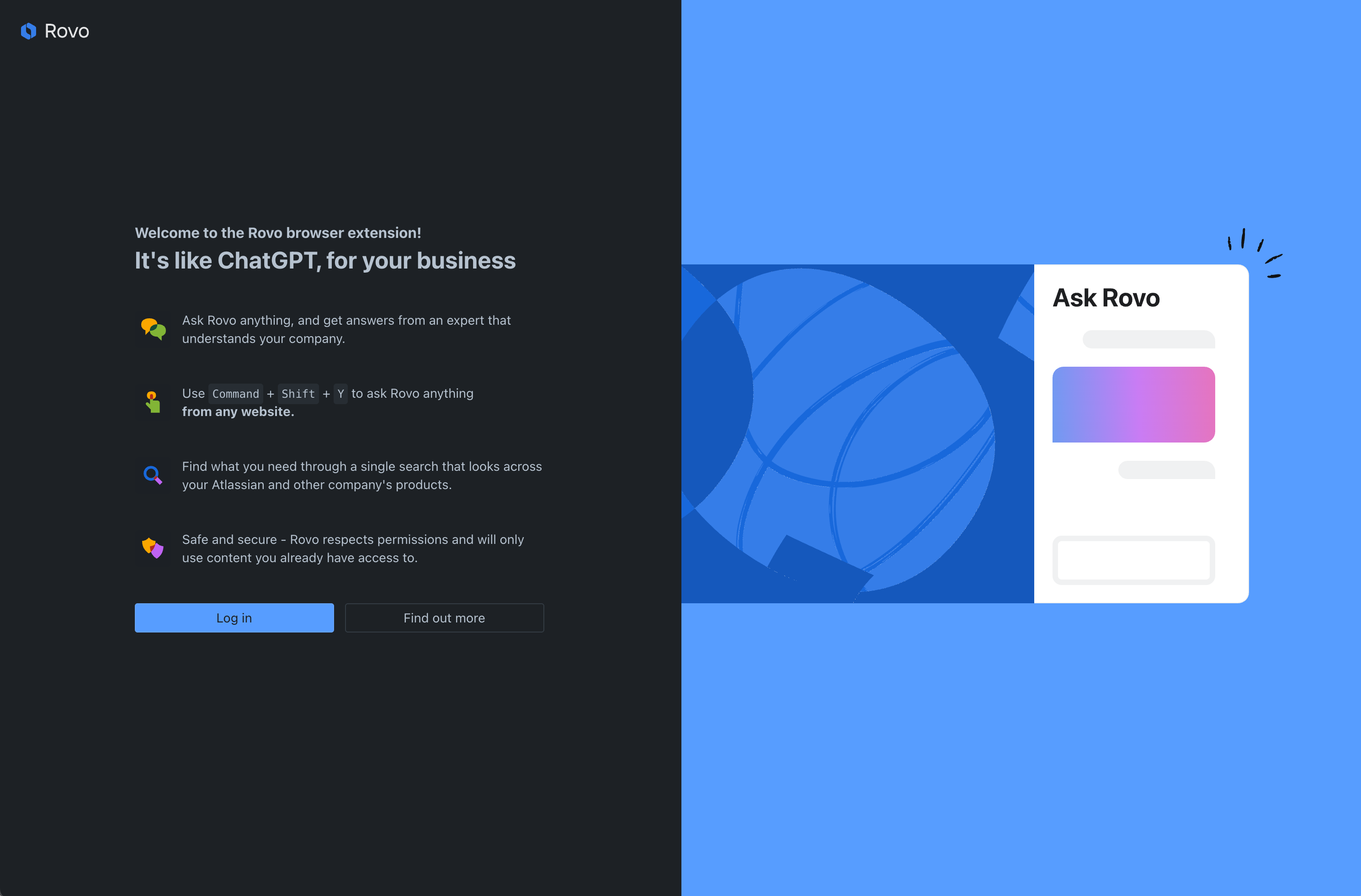

  1. Your users should see the Rovo Chrome Extension installed the next time they open Chrome. It’ll open an introduction screen that looks like this:
Screenshot of the Rovo Chrome extension splash screen
2. They may be asked to log in to their Atlassian account (if they’re not already logged in).

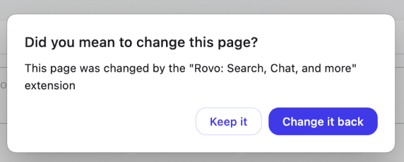

3. The next time they open a new tab, the extension will ask the user whether they’d like to set the Rovo extension as their new browser homepage. Although we recommend it, it’s not required. They’ll see a dialog message like this:
Screenshot of the "Did you mean to change this page" modal in Chrome
They can choose to:
  • Keep it to try Rovo’s new tab page. They can switch this back at any time.
  • Change it back if they’d prefer to keep their existing Chrome homepage.
