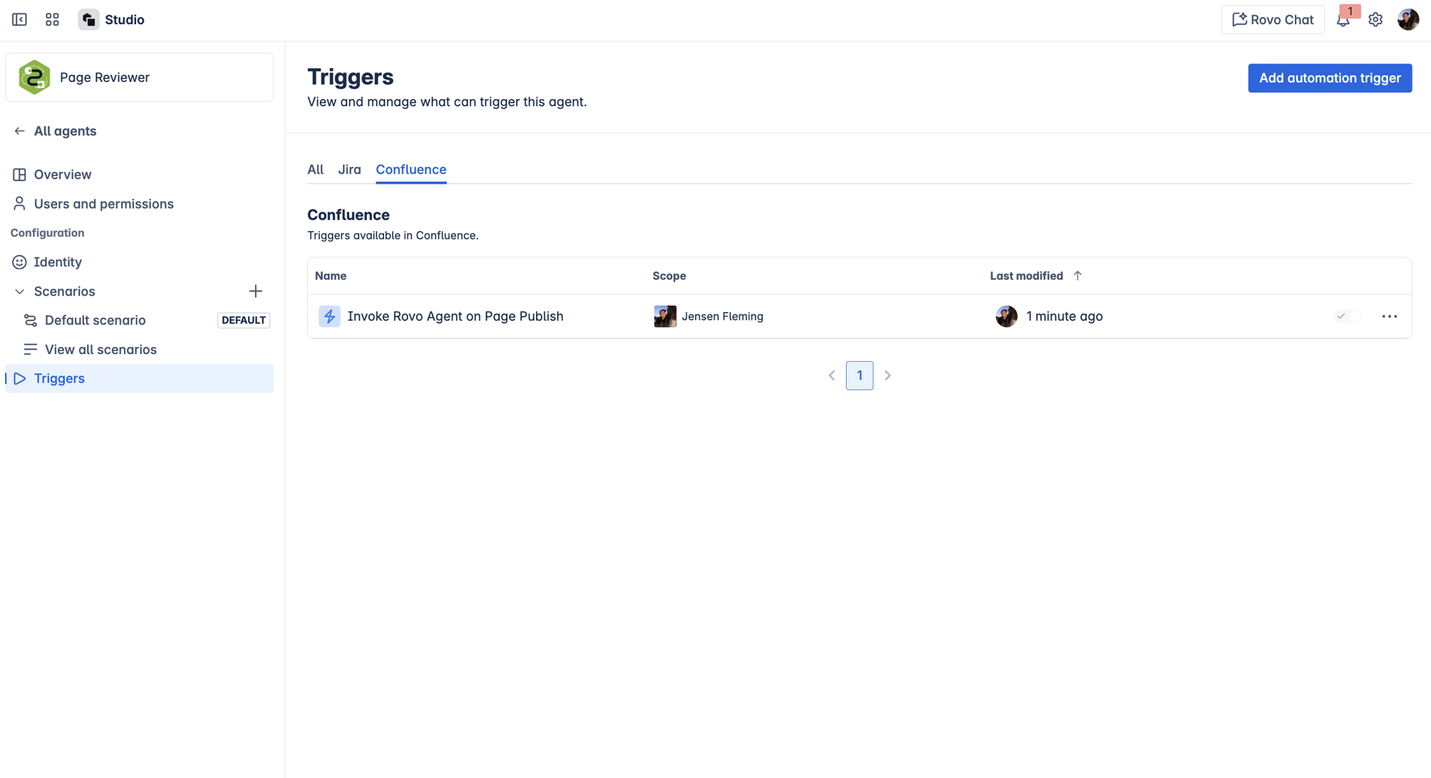

Add a trigger to an agent
If you are an agent’s manager or editor, you can add a trigger in the agent’s configuration.
  1. Use the app switcher to navigate to the Studio app
  2. Select Agents
  3. Browse to locate the agent you want to automate
    1. Select the agent to open it
  4. Select Triggers from the left-hand navigation
    1. Any existing rules that trigger this agent are listed, organized by app
  5. Select Add automation trigger to configure an event that will trigger this agent
  6. Select the appropriate app and space
    1. You’ll be redirected to automation in Jira, Jira Service Management, or Confluence to finish building the rule
  7. Save and enable your rule
    1. Refresh your agent’s Triggers screen to see it listed
An agent's settings show a rule that can trigger it in Confluence

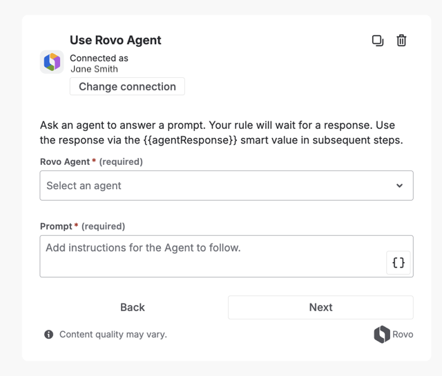

  7. Select Next > THEN: Add an action
  8. Find and select the action, Use Rovo agent
    1. Connect Rovo to automation to allow agents to act on your behalf
    2. Select an agent (required)
    3. Write a prompt (required)

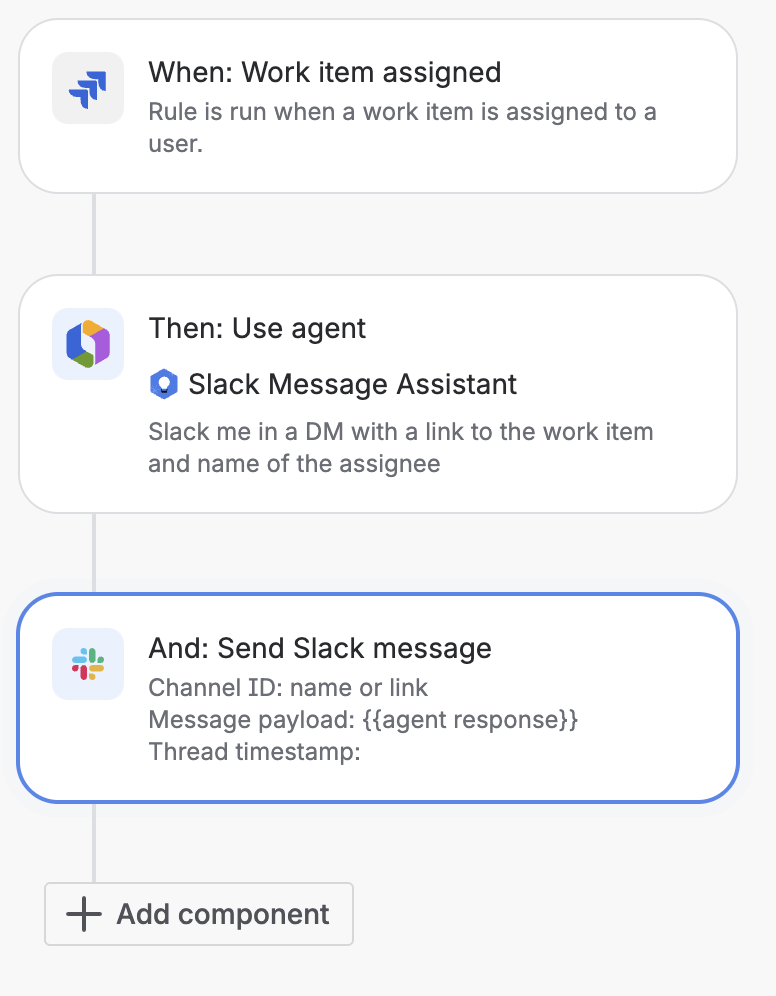

  9. Add a second action to tell the agent what to do
    1. Configure it with {{agentResponse}} (more details below)

When "work item assigned" Then prompt Slack Message agent to "DM ticket link and assignee" And Send Slack {{agentResponse}}.

When you use a Rovo agent in an automation rule, you’ll need to write a default prompt — in the same way you’d prompt an agent directly. Each time the rule is triggered, this prompt is sent to the agent on your behalf.
As long as the object in your prompt matches the object from your chosen trigger, the appropriate context will be provided.

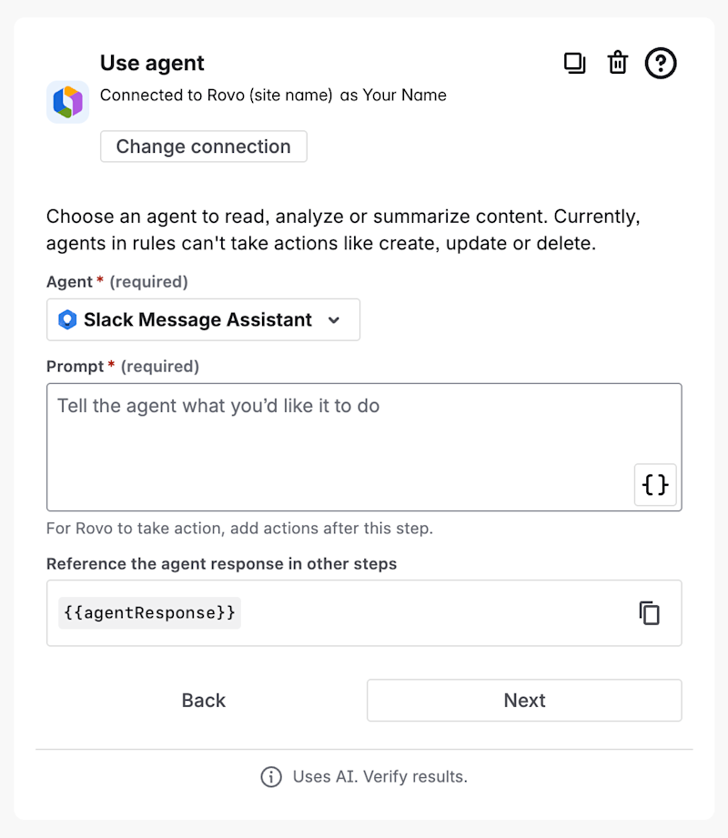

Add a second action – with text output
To use the agent’s response, you must add a second action that can leverage it. That is, it’s not enough to add a Rovo agent to a rule — you have to give it another action to execute.
When agents are automated, they execute actions on behalf of you and your rule rather than perform the skills they were configured with.
This means if you want the agent to add its response as a comment, you have to add the Add comment action — whether or not an agent’s profile contains the Add comment skill.
And since the agent’s response is text-based, you must choose actions that generate text output. Think of it as if you were chatting with the agent — the response would appear as text in the Chat window.
For now, only a few actions generate text output (and can therefore use the agent’s response), but more will be added over time.
Use the smart value, {{agentResponse}}
Once you select a compatible secondary action, type the smart value {{agentResponse}} in the configuration field. This inserts a uniquely generated response each time the rule runs.
