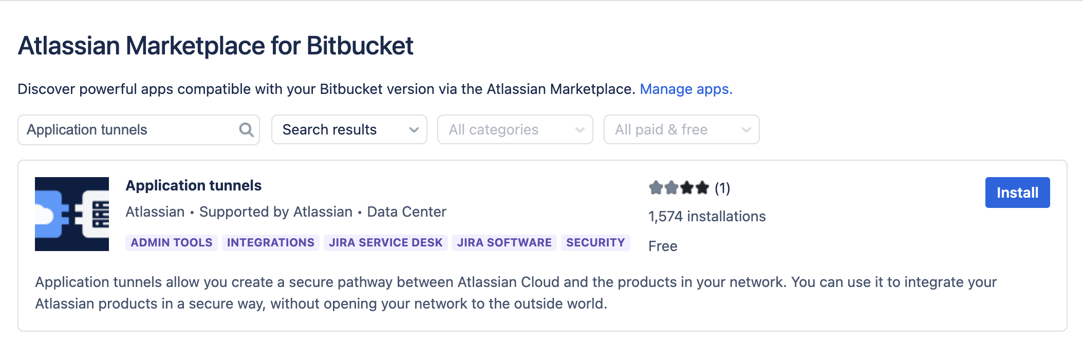

Go to Bitbucket Administration >> Find New Apps >> search for Application tunnels
Click on the Install button, you'll see the below when it's downloaded and installed and ready to use.
Refresh the page, you’ll now see Application tunnels under Administration >> SYSTEM on the left Menu.

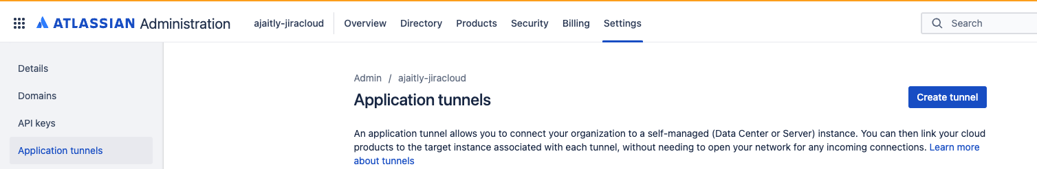

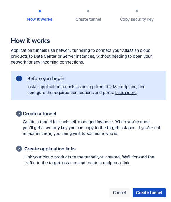

Create a tunnel from admin.atlassian.com
To create a tunnel from admin.atlassian.com:
Go to admin.atlassian.com, and select your organization.
Go to Settings > Application tunnels.

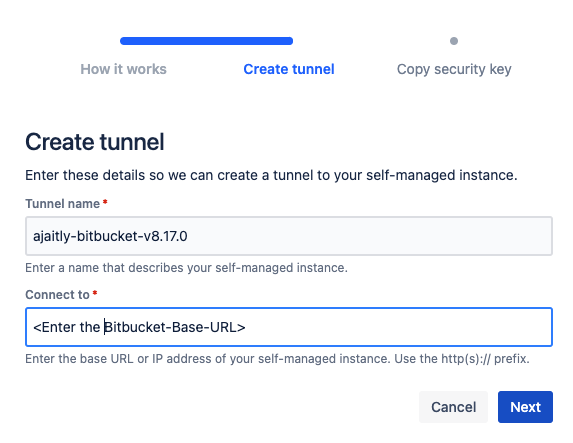

Click on the Create tunnel button
4. Go through the wizard to provide the details of your Bitbucket Server instance and generate the security key associated with your tunnel.

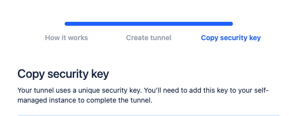

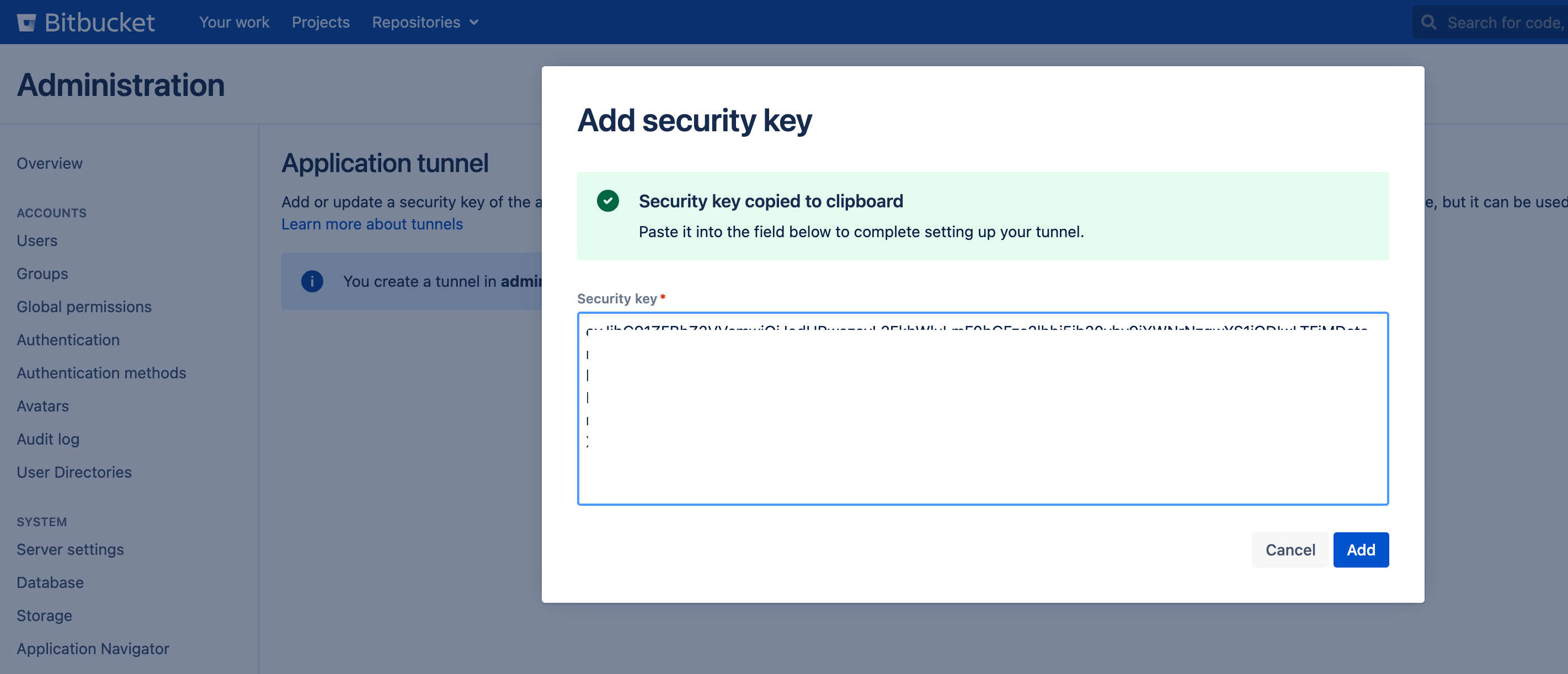

5. When you click on Next, you'll be redirected to a screen where you need to copy the security key to be entered in your Bitbucket server instance.
6. Add the key to your Bitbucket server instance. You can either choose to be redirected to your instance or copy the key and give it to the admin of this instance so they can add it manually.

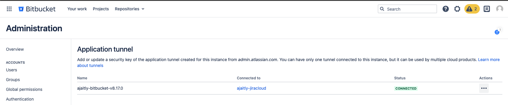

Add the tunnel’s security key to your Bitbucket Server instance
To add the tunnel’s security key:
Go to application tunnels:
If you were redirected here from the cloud, you should already be on the right screen.
If you weren’t redirected, go to Administration > Application tunnel, and select Add security key.
Paste your security key and follow the steps in the wizard.
Your tunnel is created. Wait until its status changes to Connected. For more info on statuses, see Available statuses for application tunnels.
If a tunnel displays the Error status…
Because of an incident on our side, some application tunnels might have stopped working. If a tunnel worked previously, but now displays the Error status, restart the Marketplace app in your self-managed instance. Learn more
Example
This is how a sample tunnel looks in your Bitbucket server instance:

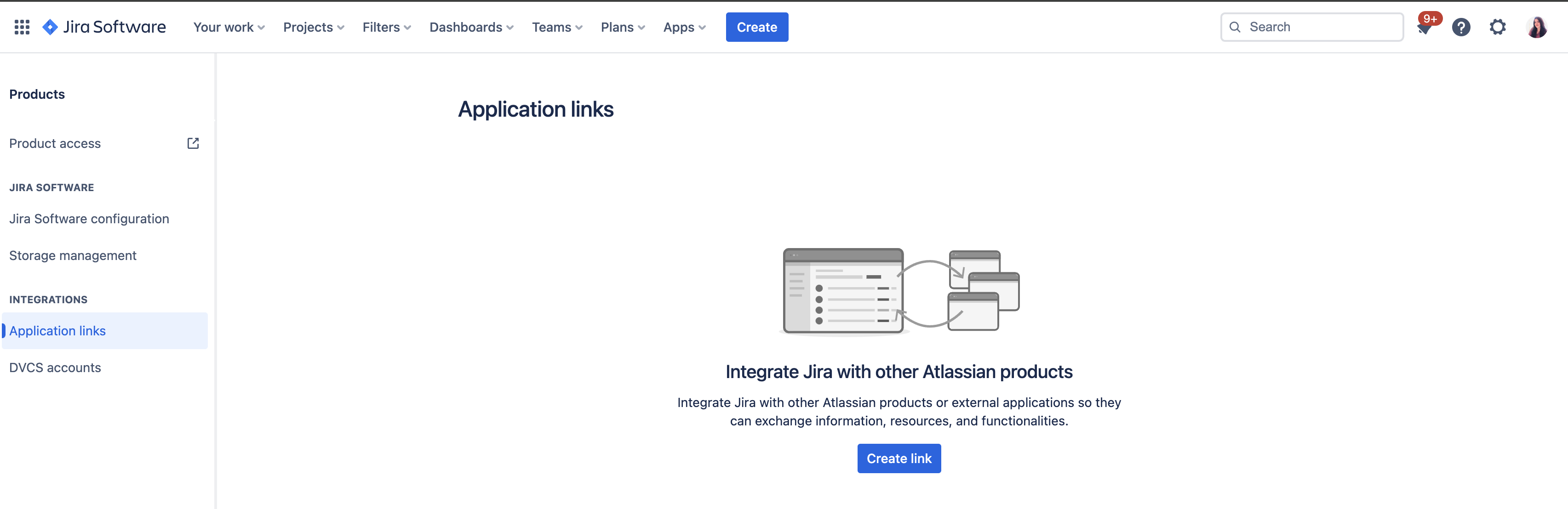

Go to the Jira Cloud UI and Administration >> Products >> Application links page. This is different from admin.atlassian.com, each product has its own administration.
Click on the Create link button:

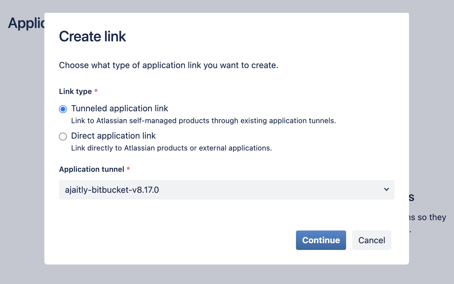

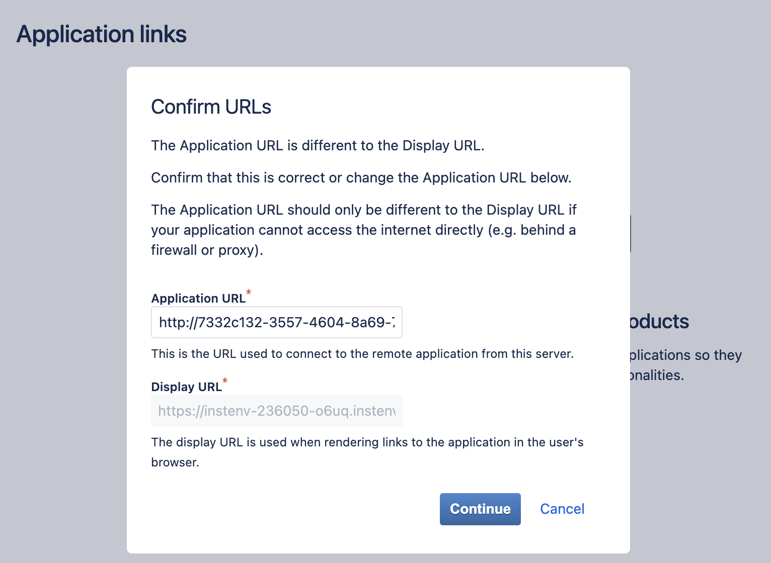

3. On the Create link screen, select the Tunneled application link option, and then choose the application tunnel from the dropdown that is connected to your Bitbucket server instance. Next, click on Continue.
4. On the Confirm URLs screen, check the URLs and confirm them. Application URL should show the URL of the tunnel, and Display URL the base URL of your Bitbucket server instance. Click on Continue:

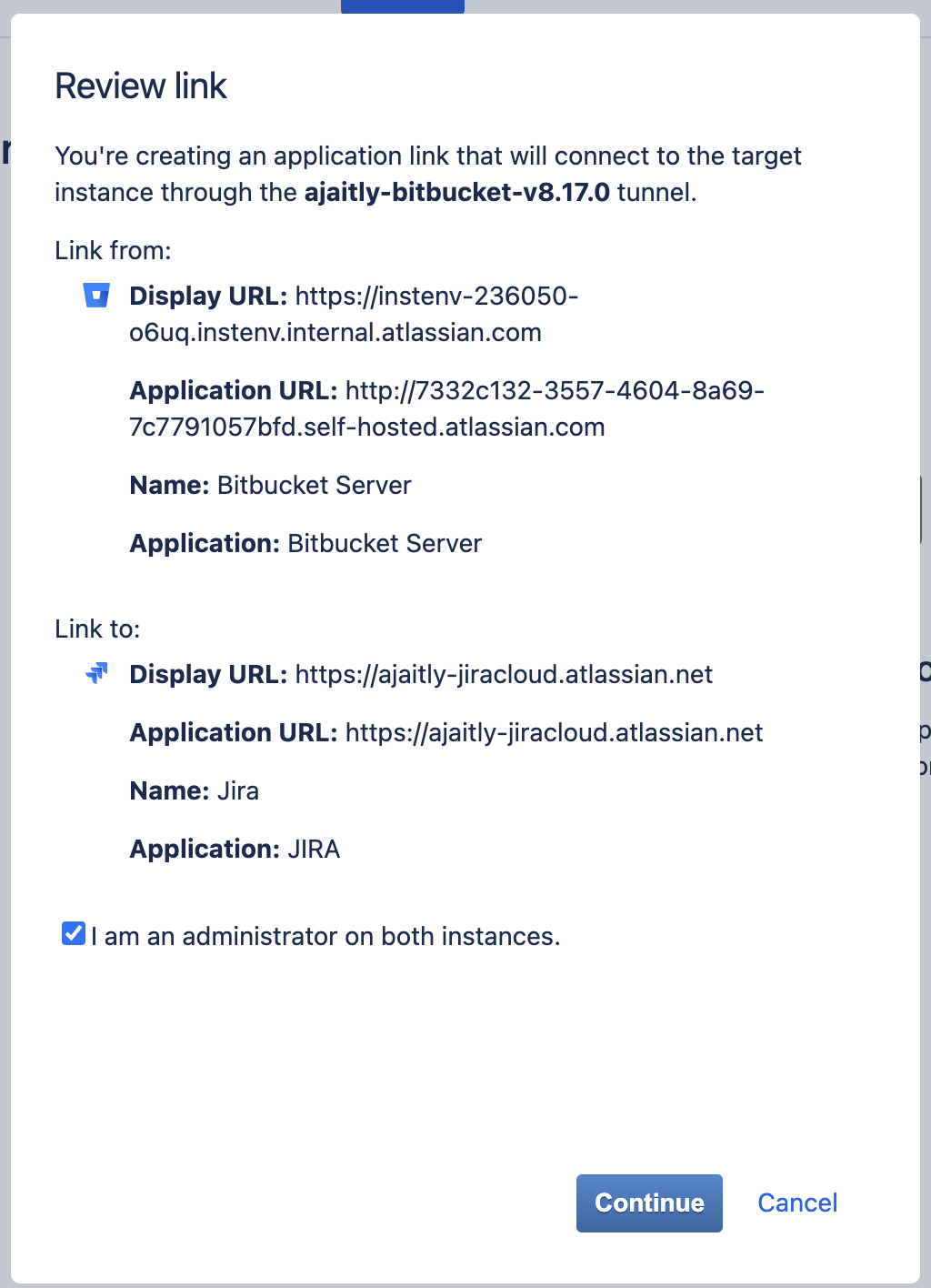

5. On the Review link screen, you’ll see the details of the products you’re connecting:

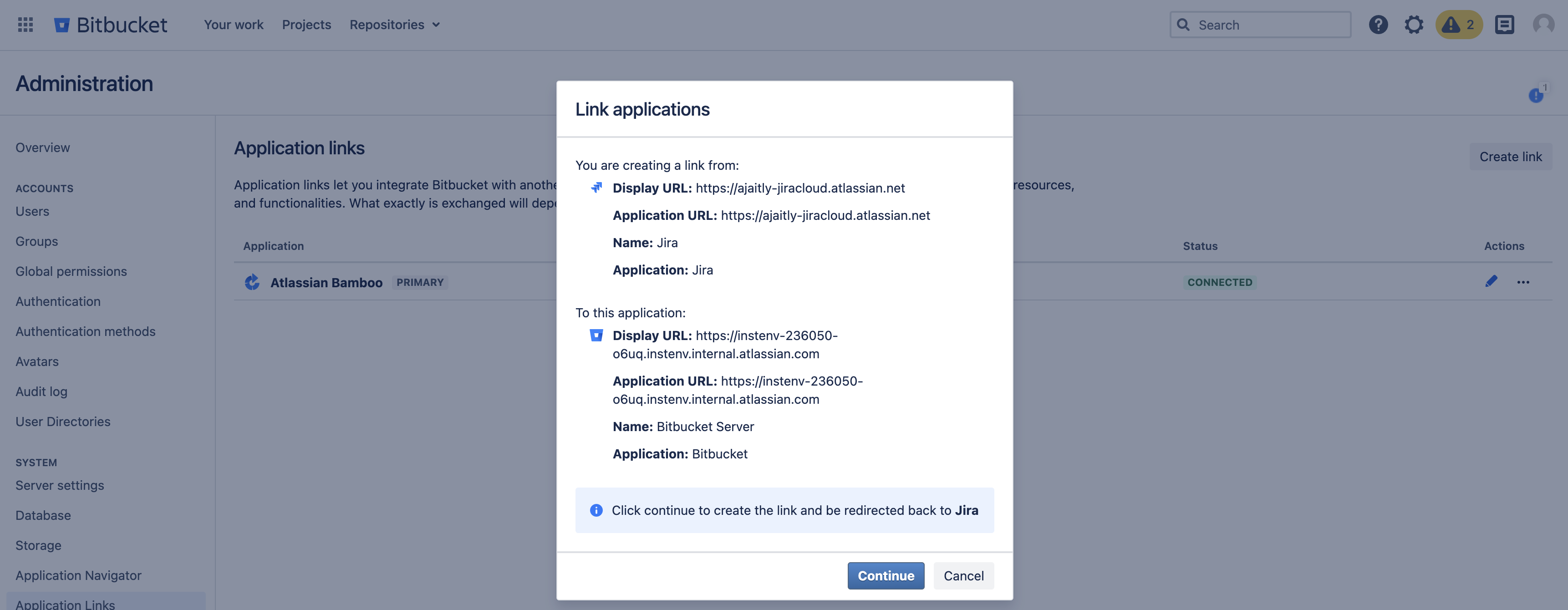

6. When you click on Continue, you’ll be redirected to the Bitbucket Server and see the below:

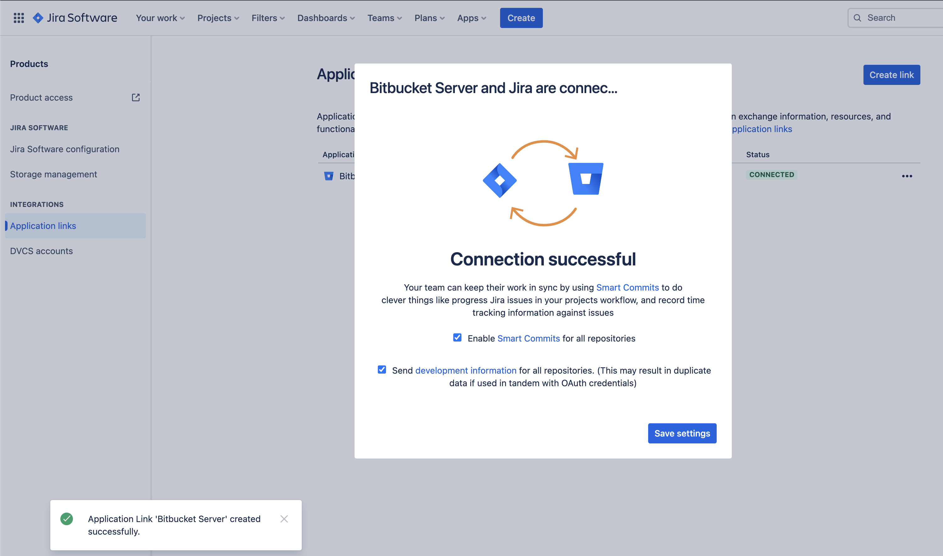

7. Click on Continue again, you’ll be redirected back to the Jira Cloud screen, and see the below. Click on Save settings:

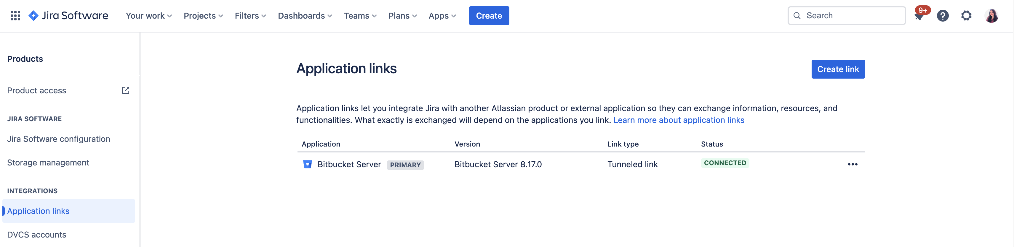

The status of the Bitbucket server applink on the Jira Cloud will show up as Connected:

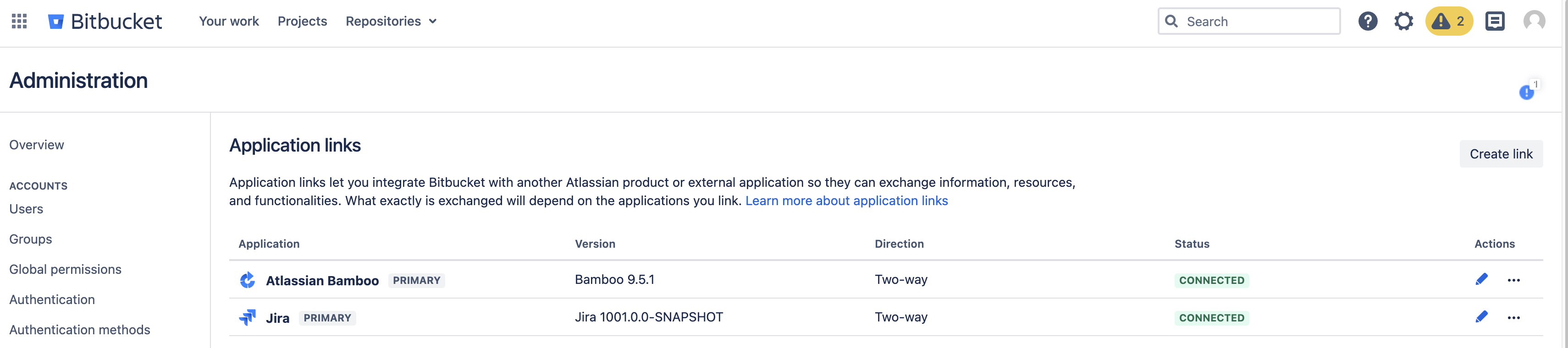

8. Now go to the Bitbucket Server UI >> Administration >> Application Links page to confirm if the Jira Cloud applink shows up there as Connected:
The Tunneled application link between your self-hosted Bitbucket instance and Jira Cloud is successfully created.
