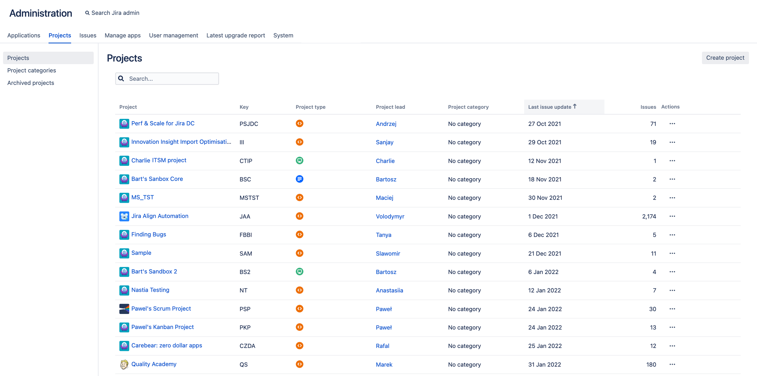

Identify inactive projects
When viewing this insight, you’ll have an option to select View inactive projects in Jira. This is a link to project list in your Jira instance, where projects are sorted by last issue update.
You can also go to Administration > Projects, and select the Last issue update column to sort them:
List of sample projects in Jira.

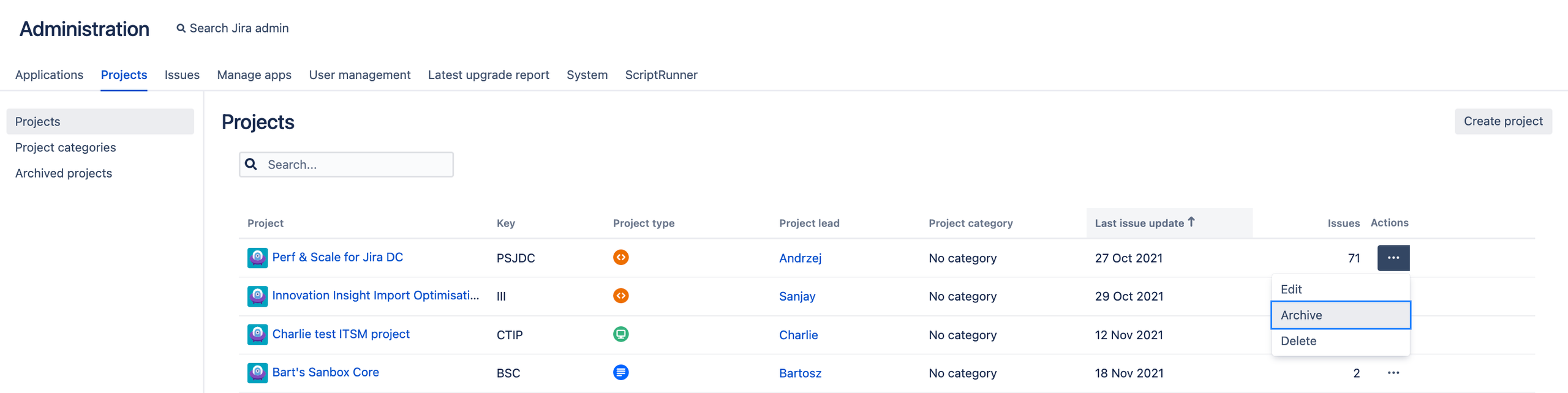

Archive inactive projects
You can’t archive projects in bulk, so you’ll have to archive them one by one.
To archive any project:
  1. Go to Administration > Projects.
  2. Next to your project name, select Actions (…) > Archive project.
  3.
Archive project option shown in the menu.
Your project will disappear from Jira, and will land in the Archived projects page. When using the migration assistant, you’ll be able to filter archived projects.

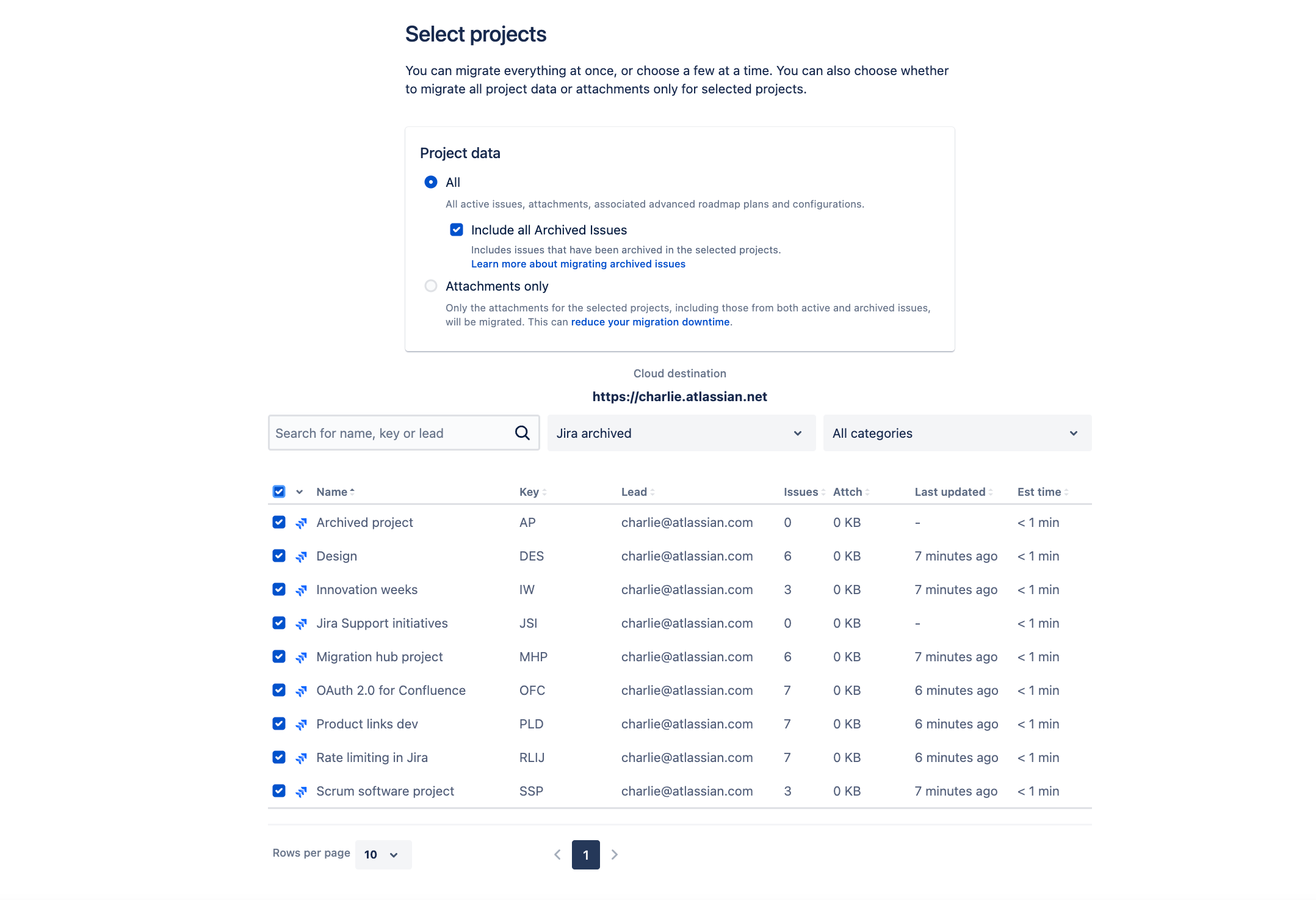

When using the migration assistant, you can quickly add all archived projects into a separate migration plan. If you haven’t archived all inactive projects, you can also include them.
To pre-migrate archived projects:
  1. Go to Administration > Migrate to cloud.
  2. Create a new migration plan.
  3. Follow the steps in the wizard until you reach the screen where you can choose what to include in your migration.
  4. In the Projects card, where you can select projects to include, use the Jira archived filter in the drop-down to list only archived projects.
  5. Select the Select all check box, and add them to your migration plan.
Selecting projects in Jira Cloud Migration Assistant.

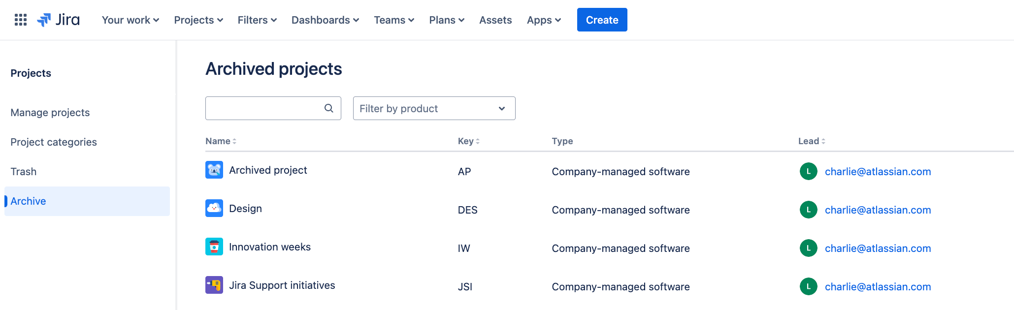

What happens to archived projects after migration?
Archived projects in cloud look and behave in a similar way as in Server or Data Center. You can view and restore them from the same Archived projects page in the Jira administration.
Page with archived projects in Jira Cloud.
Pre-migrate archived projects
Before you begin
Migrating projects in phases comes with risks and limitations, mainly related to app dependencies and configuration items that should be migrated together. Before you start pre-migrating projects, check known issues and best practices.
Early access: Dividing your migration into phases
