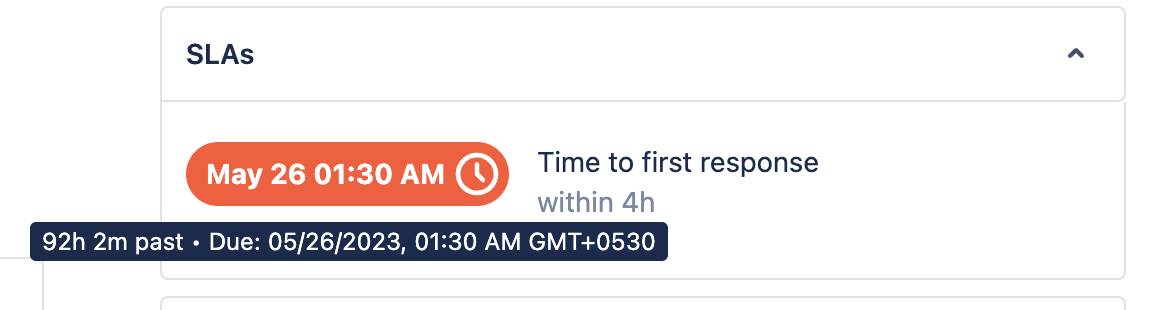

Review your SLA configuration under Project settings > SLA.

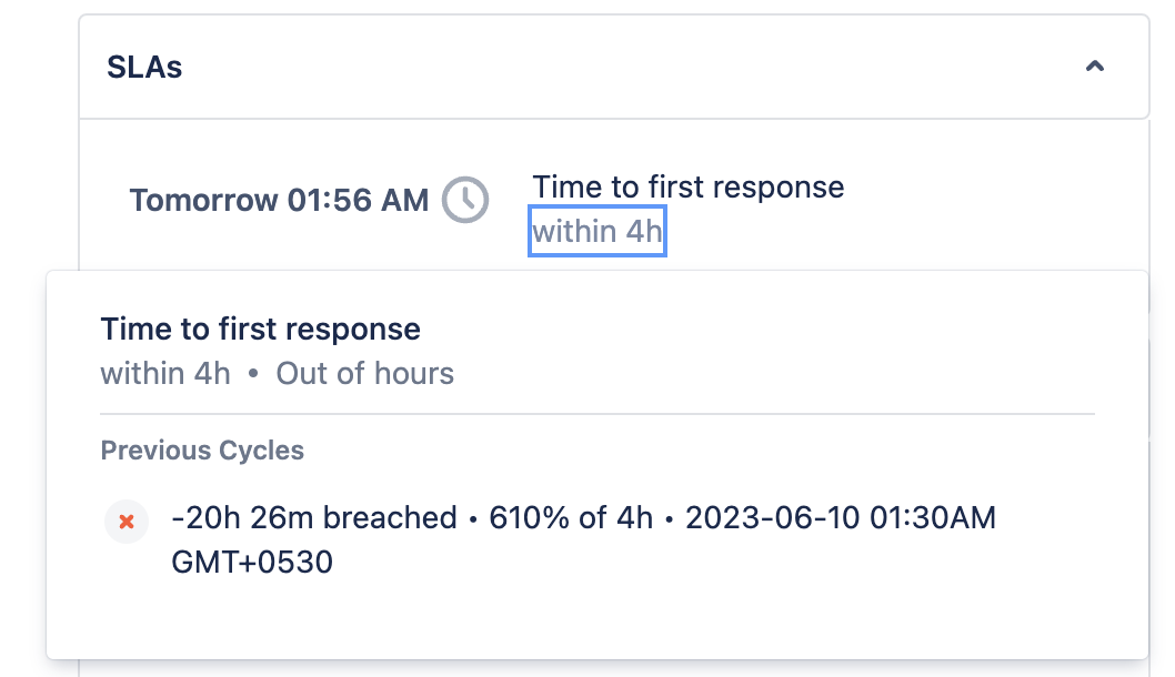

START/PAUSE and STOP conditions: Are these aligned with your business needs? Are the same triggers used for multiple conditions?
For example, having the same conditions defined for START and STOP can trigger multiple SLA cycles on the issue.
In such cases, you can see multiple cycles on the SLA for each START and STOP condition met in the issue history. Click on the tab "within 4h" to get a list of all completed cycles.
Now, verify if these cycles match your configuration.
The target that is supposed to be displayed on the issue, you would need to match the JQL of each goal to figure it out.
For example, if the ticket is supposed to have an 8h Time to first response SLA but shows 4 hours, verify the goals to see if the issue matches any in the top-down order. The first matching one is applied.
