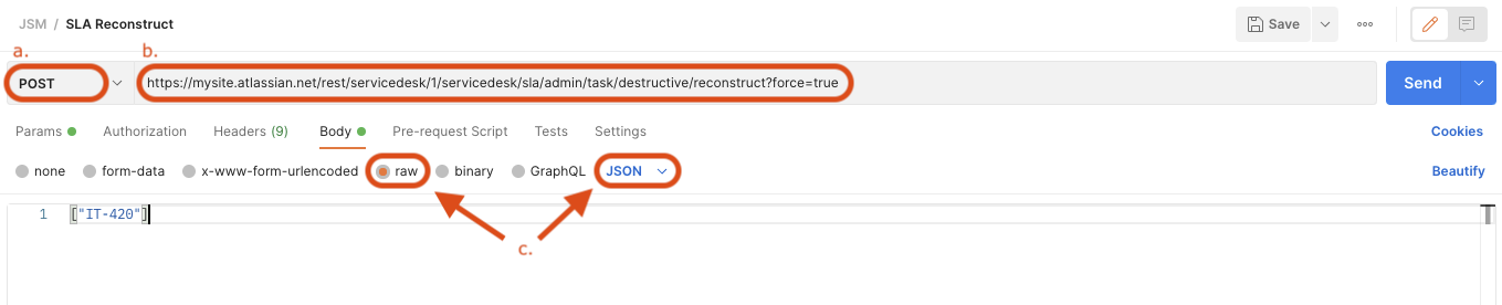

  2. Create a new request with Postman
    1. Choose the type POST.
    2. In the URL box, paste the following URL, replacing mysite.atlassian.net with the link from your site:
      https://mysite.atlassian.net/rest/servicedesk/1/servicedesk/sla/admin/task/destructive/reconstruct?force=false
    3. On the Body tab, click Raw and JSON.
    4. In the text box, add the affected tickets using the format ["TICKET-001", "TICKET-002", ..., "TICKET-1234"].

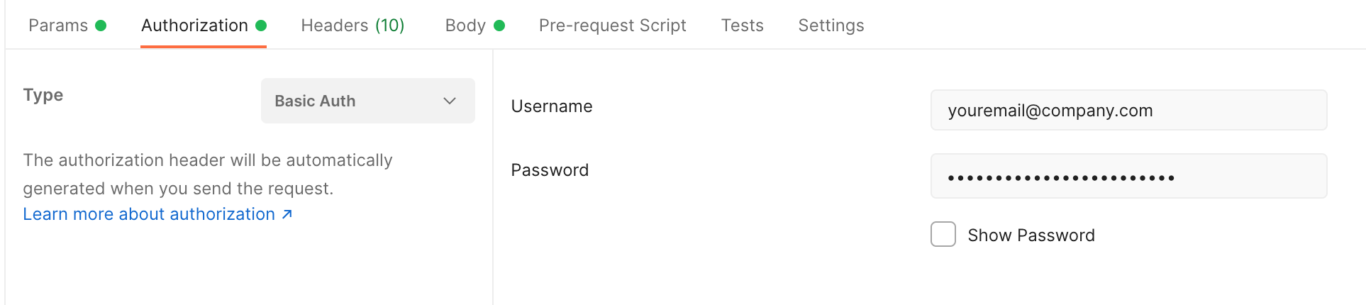

  3. Authenticate with your Atlassian account. To do this, create an API token.
    1. Go to Atlassian account > Create API Token.
    2. Add a label and click Create, and your token is ready to go.
  4. In Postman, click Authorization, then select Basic Auth.
    1. Type the email you use to log in to your Service Management site.
    2. On Password, paste the token you generated in the previous step.

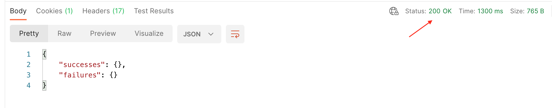

  5. With everything configured, it's time to correct the SLAs. To do this, just click SEND.
  6. Once you click SEND, if everything goes well, it will show the "status: 200" in the bottom right corner.

  • Confirm the request returned status 200 (Postman shows it in the bottom-right).

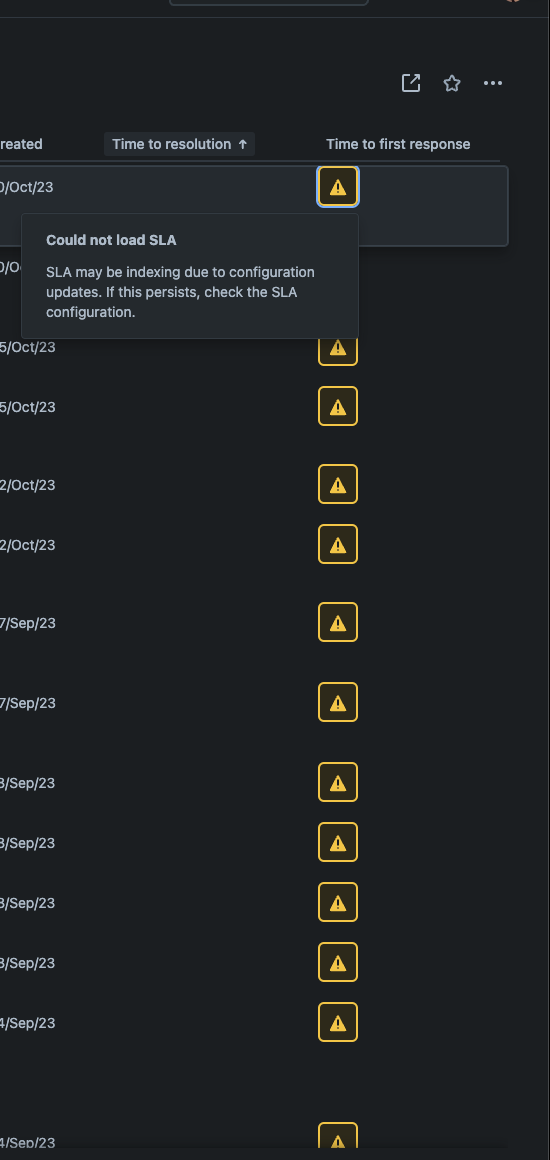

  • Expect the SLA to temporarily disappear from the queue/issue view while it re-indexes — the message "Could not load SLA. SLA may be indexing due to configuration updates" is normal during this window.

NOTE: When an SLA is updated for a Jira Work Item, it'll display the message, "Could not load SLA. SLA may be indexing due to configuration updates. If this persists, check the SLA configuration."
The SLA will re-index/re-calculate, temporarily removing the SLA value from the queue view (for example) for open Jira Issues that meet the criteria for having that SLA populated.
Please note that the SLA panel will not show on the Jira Issue(s) view as well, during the recalculation. If the recalculation is to a lot of issues it can take some time for the SLA to populate to the Jira Issue or JSM Queue. For example, if there are 1000 Jira Issues to recalculate an SLA for, using a method mentioned above, this will take some time to re-define the value for the open Jira Issue(s). So, please be patient while this process is completed.
