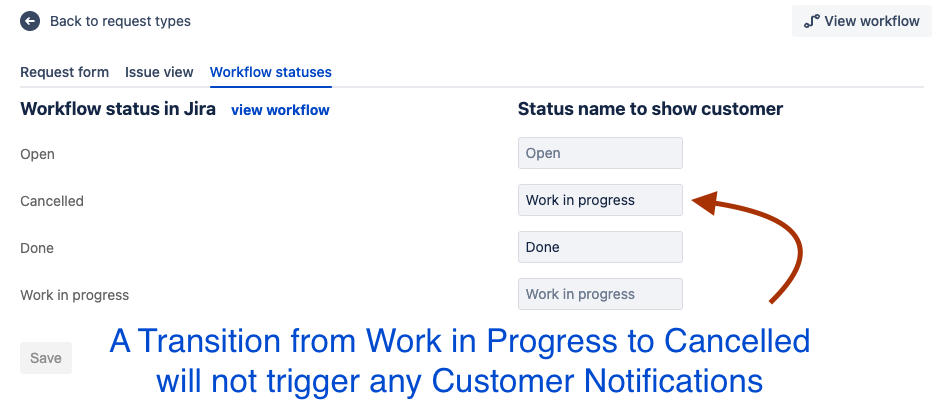

Hide the transition from the customer portal
It is possible to customize the workflow statuses for a request type. This means you can hide statuses in your workflow from the portal while still having the work item transitioned internally in Jira.
If there is no publicly visible status transition in the portal, the customer will not be notified. The customer will still receive a notification when the resolution is set on the request.
The downside of this solution is that the status transition will be fully hidden from customers, even in the portal.
A transition between two workflow statuses can be hidden from the customer by giving them the same status name in the request type configuration page (in Project settings > Request types, inside a request type in the Workflow statuses tab).

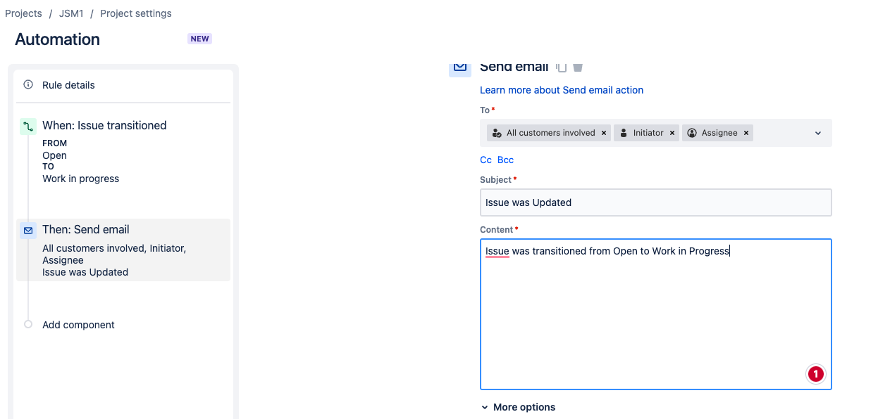

Workaround using automation
If the solutions above don't solve your issue, you can consider using an automation rule to trigger notifications only for specific cases:
  1. Disable the customer notification for Customer-visible status changed.
  2. Create an automation to send notifications for specific transitions.
A base example of how the rule can be configured:
  1. Trigger: work item transitioned. Select all the statuses that you require the customer to be notified about.
  2. Action: send email. Customize the body of the email.
    1. The smart value {{issue.status.name}} can be used to customize the email to send the name and status of the work item to the user.
You can use other smart values and HTML to configure the content and shape of the email. For assistance with setting up an automation rule, see "Create a custom automation rule."
