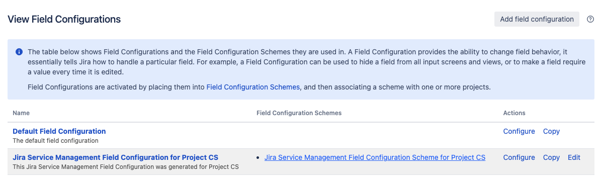

  3. Go to Settings > Issues > Field Configuration.
  4. Select the field configuration for your project.

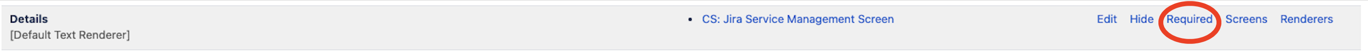

  5. Locate the Details field and mark it as Required.
  6. The custom field will change to Required.

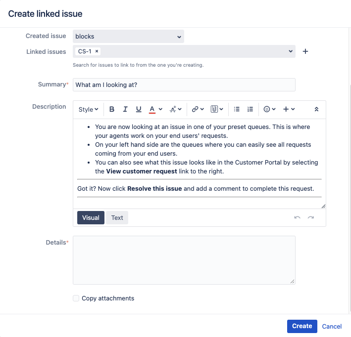

  7. Open the desired work item and select More > Create linked work item.
  8. The Details custom field is displayed on your Created linked work item Screen.
