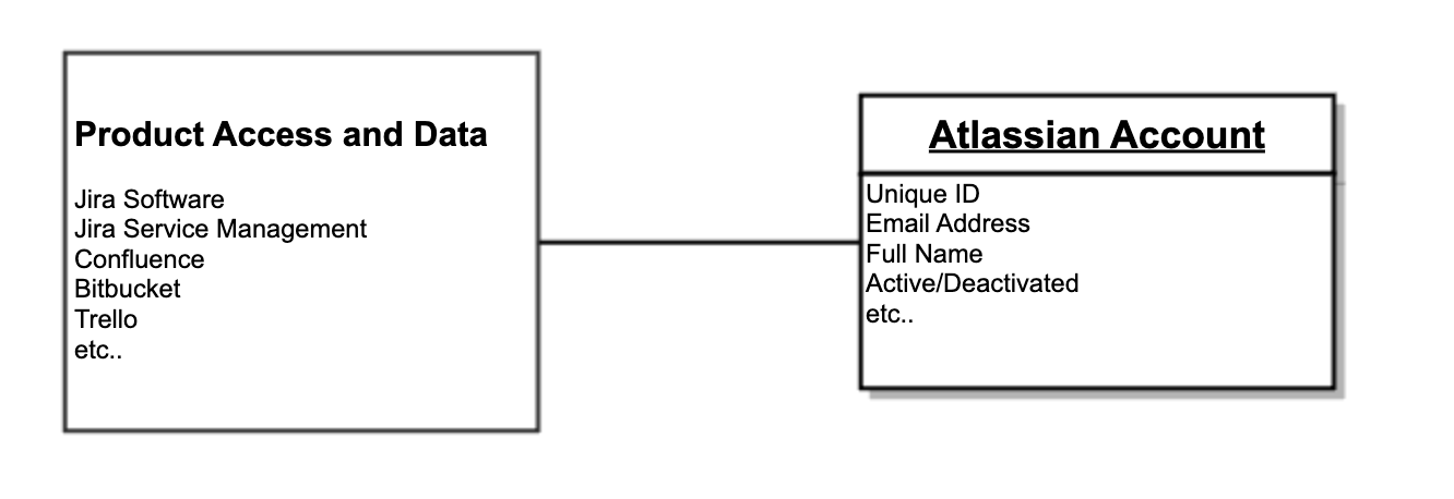

Product access and historical data in cloud products are not linked to the Atlassian Account or the email address. Each Atlassian Account is identified by a unique (immutable) ID and an email address. If an Atlassian Account’s email address is updated, the end user can continue to use their existing product access and data with the new email address.

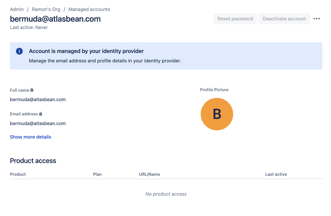

  • Managed accounts that are linked to the identity provider via provisioning are locked for editing on Atlassian side. The Atlassian Account email address can only be updated via the identity provider.

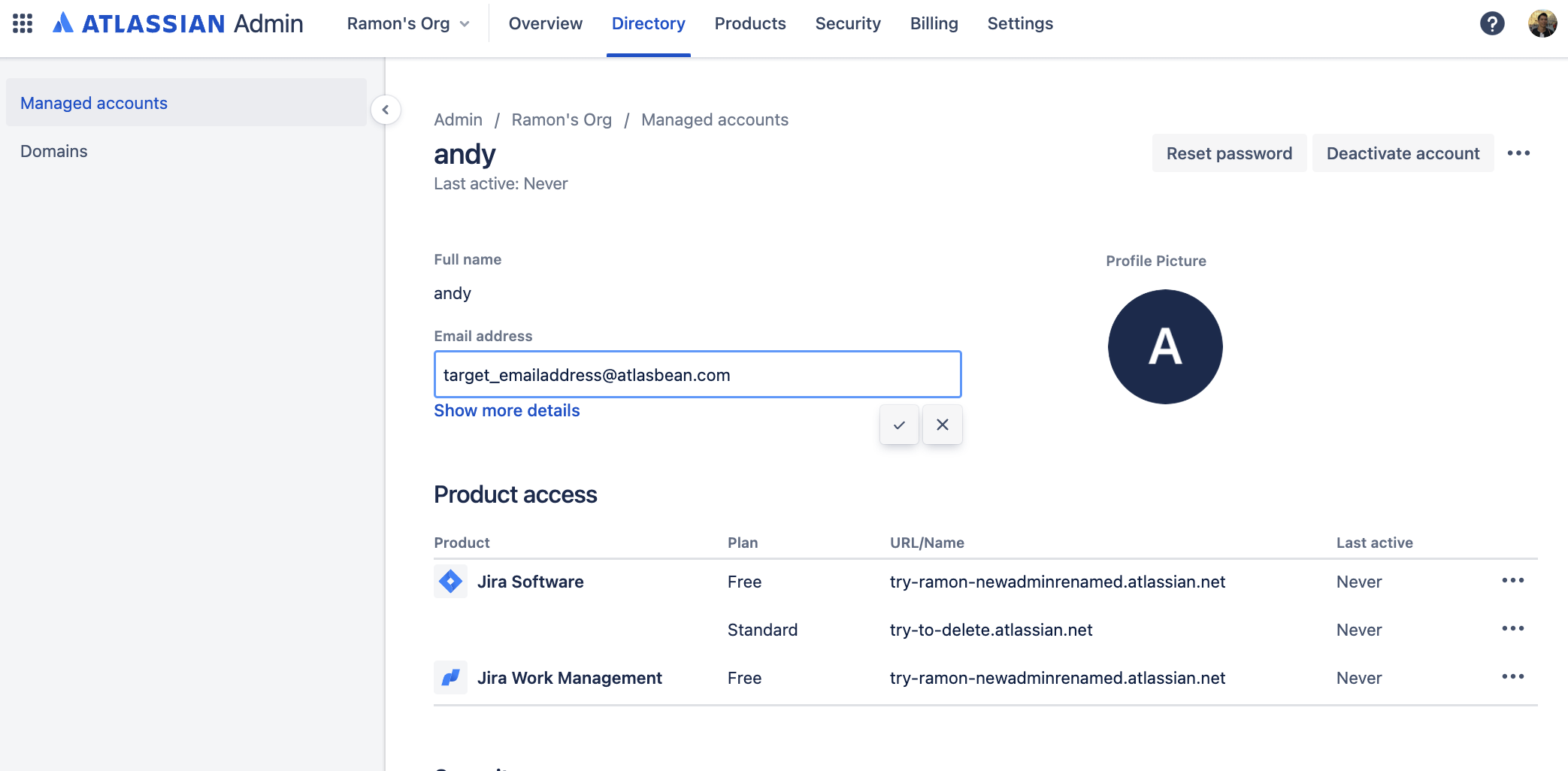

Update the Atlassian Account email address via the Managed Accounts administration or use the Set Email Organization API to change the email address in bulk.
