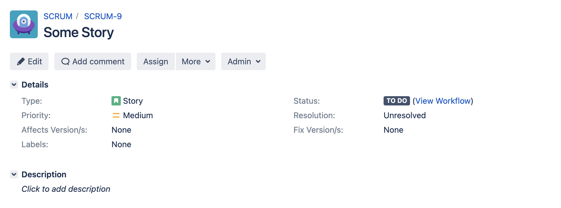

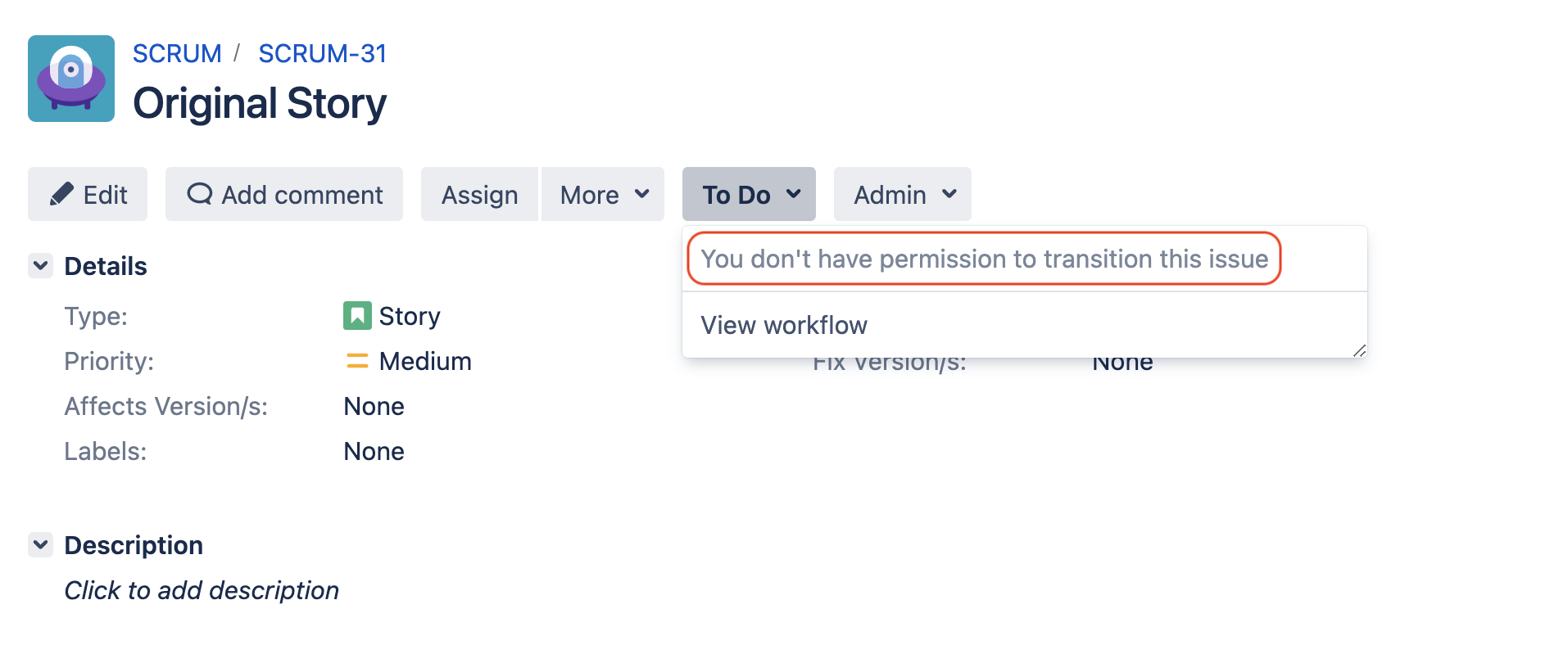

Some users are unable to transition a Jira issue. Depending on the Jira version that you are using, the symptoms will be slightly different:
  • On Jira versions below 9.0.0, the workflow transition buttons are missing from the issue view page:
  • On Jira versions above 9.0.0, there is a drop-down next to the current status, but when clicking on it, the error You don't have permission to transition this issue is displayed:

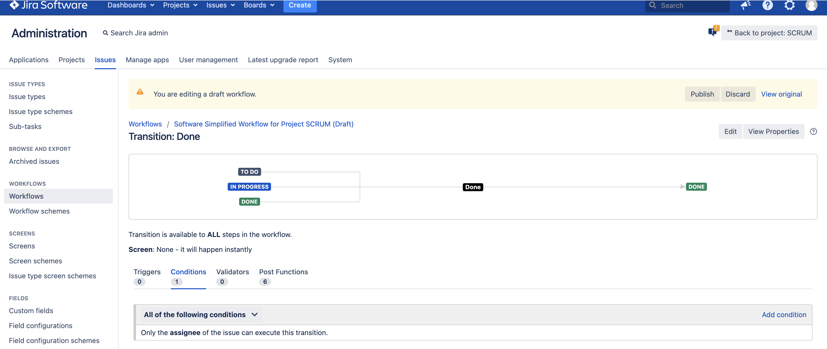

      • This can be checked by going to the the page Project Settings > Workflows, and then trying to edit the Workflow associated to the right issue type
      • Check each workflow transition that is missing from the Issue View page, to see if there is any condition associated to it. If any of the condition is not respected by the user viewing the issue, the transition button will be hidden
      • For example, when adding a condition like Only the assignee of the issue can execute this transition, The transition button will not appear when a user other than the assignee edits the issue:
