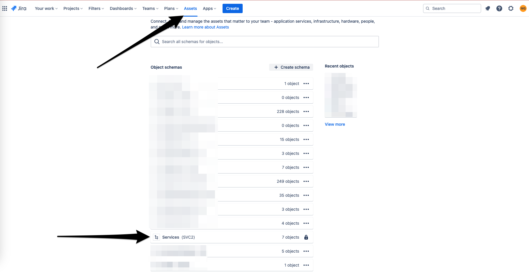

Services Schema
Before building the automation, you might want to check all the available attribute data that is currently stored in your Services. In order to do so, you should access your Assets page (look for Assets in the top navigation bar) and then access your Services schema (the one with a padlock instead of the three dots):

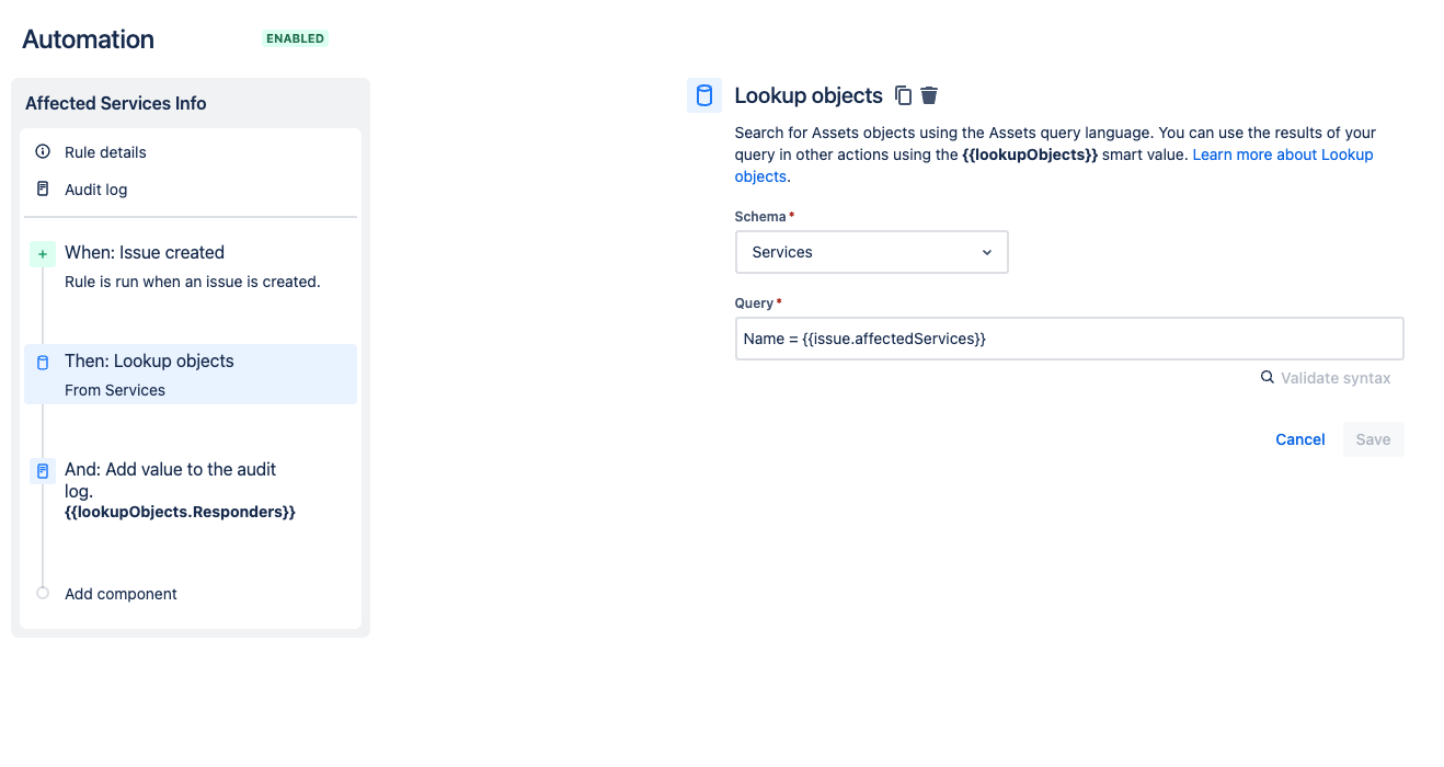

The automation rule structure may vary depending on your use case, but to get the values from a Service, you'll need a Lookup Objects action somewhere in the rule.
In the example below, I'll create an automation rule that will get the service responder's user ID.
This might be useful if you want to create an automation that'll assign a recently created issue to the responder of the service that was selected when creating the ticket, for example.
Trigger - Issue Created. The rule will run when a new issue is created, no further configuration is required.
Action - Lookup Objects. This is where we'll get all the attribute data. The AQL to be used is the following: Name = {{issue.affectedServices}}
Additional Components - as needed (assign issue, comment, log action, etc.). The values returned from the Lookup Objects action can now be accessed with the {{lookupObjects.AttributeName}} smart value (just change AttributeName to the actual name of the attribute).
So if we want to get the Responder for the service, we can use the {{lookupObjects.Responders}} smart value, for example, like in the image above.
This can be used with other automation actions, branches, and conditions, depending on your use case.
