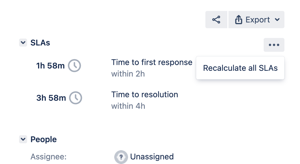

To recalculate SLAs for one issue using the UI
  1. Navigate to the issue.
  2. In the SLAs section, select More actions (…) > Recalculate all SLAs.
  3. Select Recalculate.
Jira issue view displaying SLA and People sections.  Under SLAs, Time to first response is 1 hour 58 minutes (within a 2-hour target) and Time to resolution is 3 hours 58 minutes (within a 4-hour target).  A button labeled Recalculate all SLAs is als

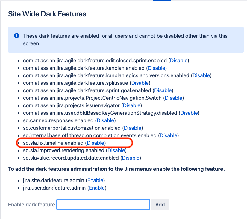

  • If you are running JSD 4.3.0 and above, you will need to first enable the dark feature sd.sla.fix.timeline.enabled per the instructions in Enable Dark Feature in Jira:
    • Navigate to the following page to access the Dark Features page:
      <baseUrl>/secure/admin/SiteDarkFeatures!Default.jspa
    • Enter sd.sla.fix.timeline.enabled in the field “Enable dark feature” and clicking on the “Add” button, and verify that the dark feature sd.sla.fix.timeline.enabled is showing:
      Screenshot of Jira's dark feature settings. The highlighted setting sd.sla.fix.timeline.enabled is circled in red and can be disabled.  Additional dark features related to agile, projects, and user settings can also be disabled.  Instructions are inc

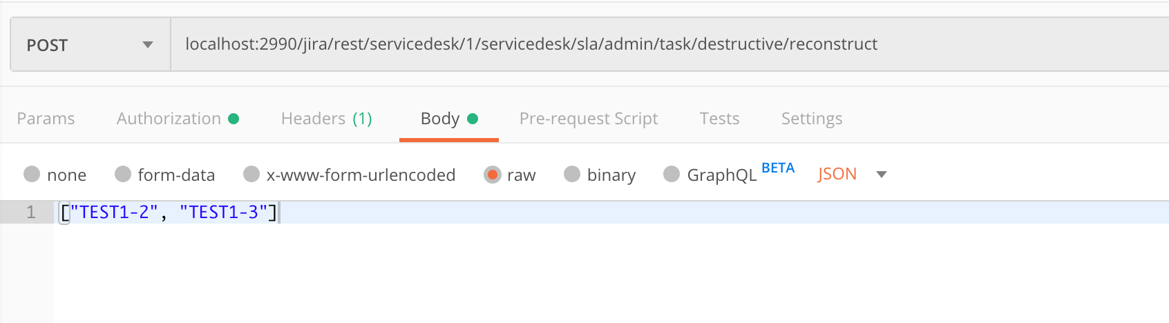

  • Perform a POST-REST call to the Jira instance through the following URL:
    <baseUrl>/rest/servicedesk/1/servicedesk/sla/admin/task/destructive/reconstruct
  • In the Authorization tab, select 'Basic Auth' type and supply your Jira credentials accordingly.
  • Along with the header: "Content-Type: application/json" and raw JSON data below within the Body section.
    ["ISSUEKEY-XXX", "ISSUEKEY-XXXX"]
  • Key in the issue key for the issue which has the missing SLA.
    You may install Postman offered by Chrome Web Store to achieve this. Please make sure you're sending a POST request with rawdata with JSON application.
    Alternatively, you can use the CURL command-line tool to do this:
    $ curl -X POST -u $USERNAME:$PASSWORD -H "Content-Type: application/json" "http://localhost:2990/jira/rest/servicedesk/1/servicedesk/sla/admin/task/destructive/reconstruct" -d "[\"TEST1-2\", \"TEST1-3\"]"
  • Performing the above REST API call will trigger a manual reconstruction of the SLA.
