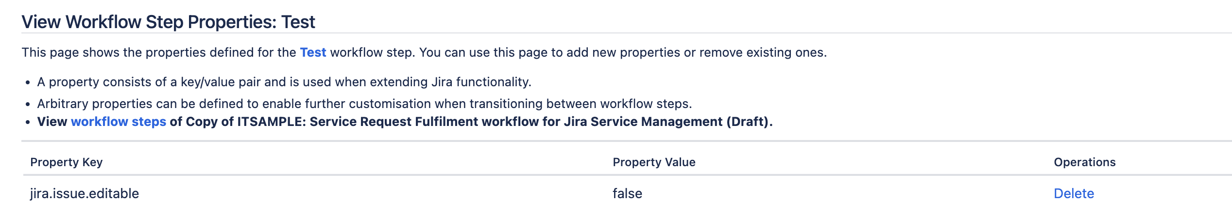

If the issue workflow has jira.issue.editable property set as false in the very first status of the workflow stops the addition of attachments after the creation of the issue. This gives a "Failed to load" error in the attachment under the issue view.

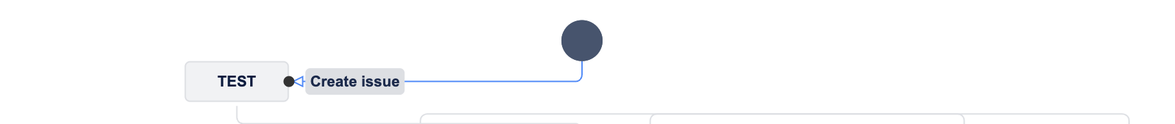

Select the affected workflow;
Navigate to the first status of the workflow which has the jira.issue.editable property set.;
Click on the status > Go to properties and delete the property;
