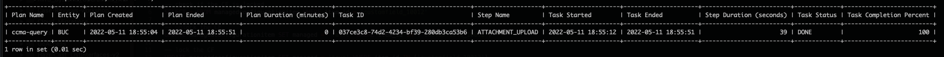

SELECT p.planName AS "Plan Name" , s.stepConfig AS "Entity" , p.startTime AS "Plan Created" , p.endTime AS "Plan Ended" , DATEDIFF(minute, p.startTime, p.endTime) AS "Plan Duration (minutes)" , s.taskId AS "Task ID" , s.stepType AS "Step Name" , s.startTime AS "Task Started" , s.endTime AS "Task Ended" , DATEDIFF(second, s.startTime, s.endTime) AS "Step Duration (seconds)" , s.executionStatus AS "Task Status" , s.completionPercent AS "Task Completion Percent" FROM MIG_PLAN p INNER JOIN MIG_STEP s ON (p.id = s.planId) ORDER BY p.startTime, s.startTime
Output (query)
You should see an output similar to the example below (depending on the database you're running it against)
