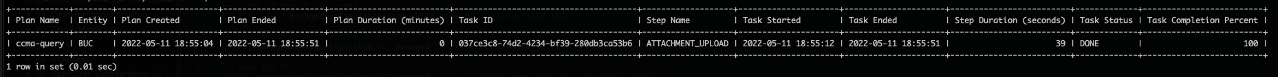

Output (query)
You should see an output similar to the example below (depending on the database you're running it against)
