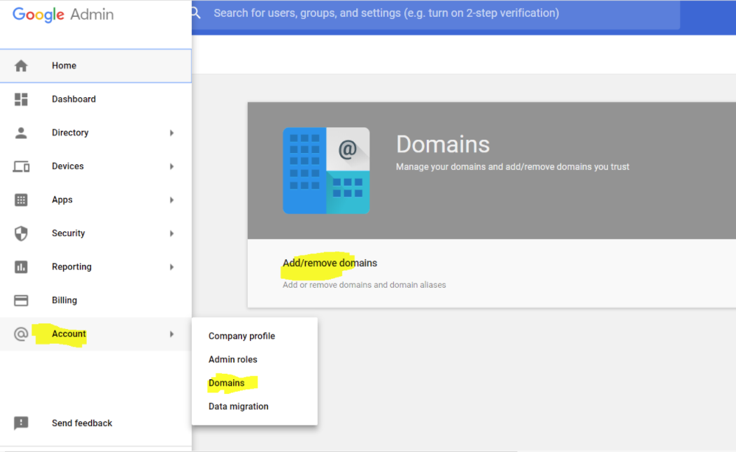

  3. Add and verify the new domain as shown in the screenshot below. https://support.google.com/a/answer/7502379?hl=en
    1. (Auto-migrated image: description temporarily unavailable)

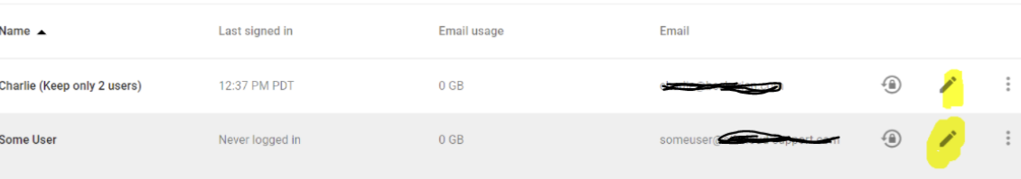

  4. Update users emails as shown in the screenshot below
    2. (Auto-migrated image: description temporarily unavailable)
