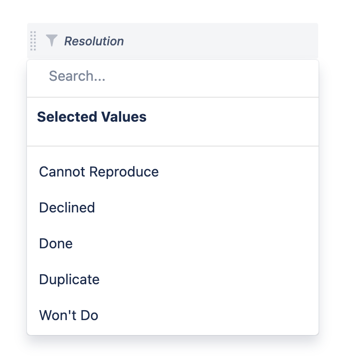

Let’s say we have a “Dropdown” control that lists all of the issue resolutions on your dashboard and has the following settings:
  • Multiple select is selected
  • When no values are selected “Show unfiltered chart data”
  • Initial value(s) is deselected

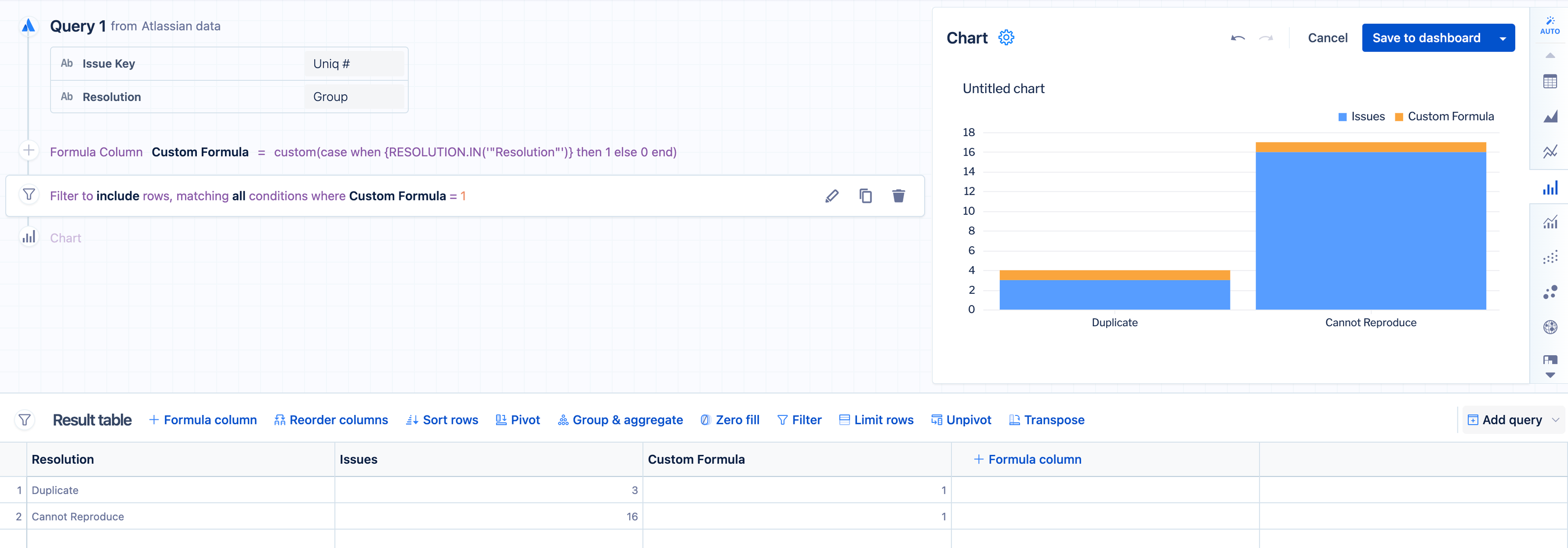

  1. First, ensure the column you want to filter on is included in your result set. Unlike filtering directly in the query, you need the column in your result set so you can reference it outside of the query. For this example, the “Resolution” column must be in the result set.
  2. Next, create a boolean column that depends on the values of the column to filter (for this example, it’s the “Resolution” column). If we want to include the row in our results, the boolean column should show a 1; otherwise, it should show a 0.
    Add a "Formula column" step, select Custom as the formula type, and use the following CASE statement as the formula, replacing DROPDOWN_NAME with the name of your “Dropdown” control and Resolution with the name of the column you’re using to filter:
    1 CASE WHEN {DROPDOWN_NAME.IN('"Resolution"')} THEN 1 ELSE 0 END
    This will connect the “Dropdown” control to your chart.
  3. Now add a "Filter" step to correctly filter on the selected values of the “Dropdown” control. Select to include rows matching all conditions where the Custom formula column equals 1 ("Custom Formula" = 1).
    Note: If you’re trying to implement an “is not one of” filter, you’d just need to change include to exclude.
  4. Lastly, hide the boolean “Custom formula” column since it’s no longer necessary. You can also hide the column used to create the boolean column if you no longer need it too.

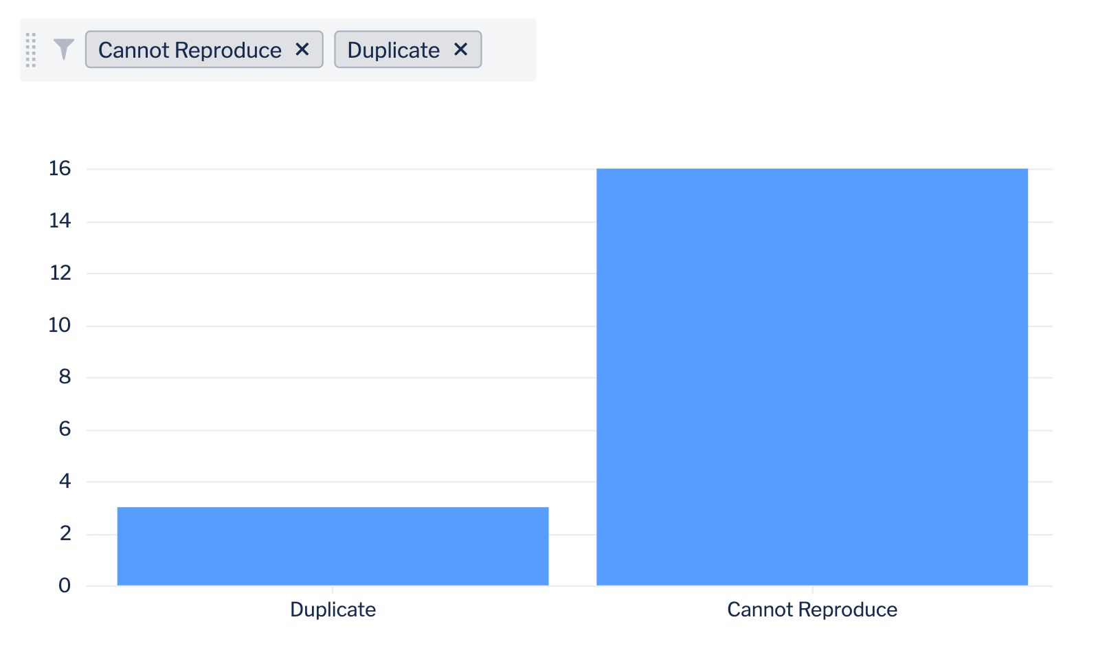

    If you followed these steps correctly, your multi-select “Dropdown” control should now be connected to your chart, and you can filter your chart using multiple selections from the “Dropdown” control of resolutions.
