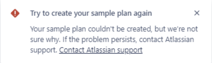

The UI does not show the generic error "Try to create your Sample Plan again".

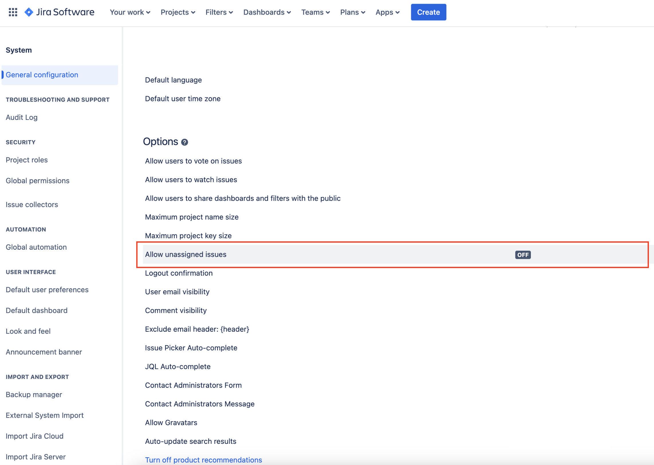

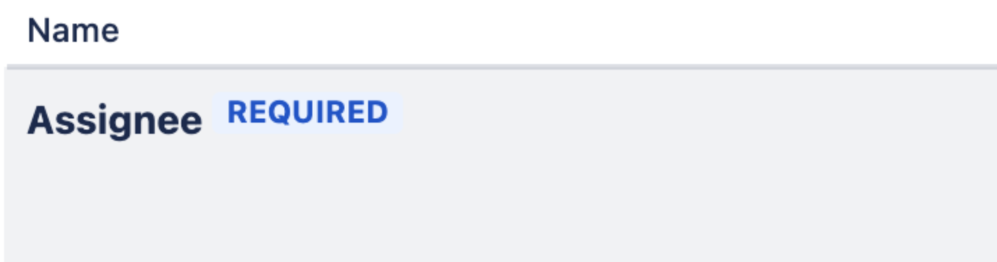

If the Jira Application option "Allow unassigned issues" is turned OFF, it marks the Assignee field Required.
This option needs to be turned ON so that the Assignee field becomes Optional and the Sample plan can be created.
