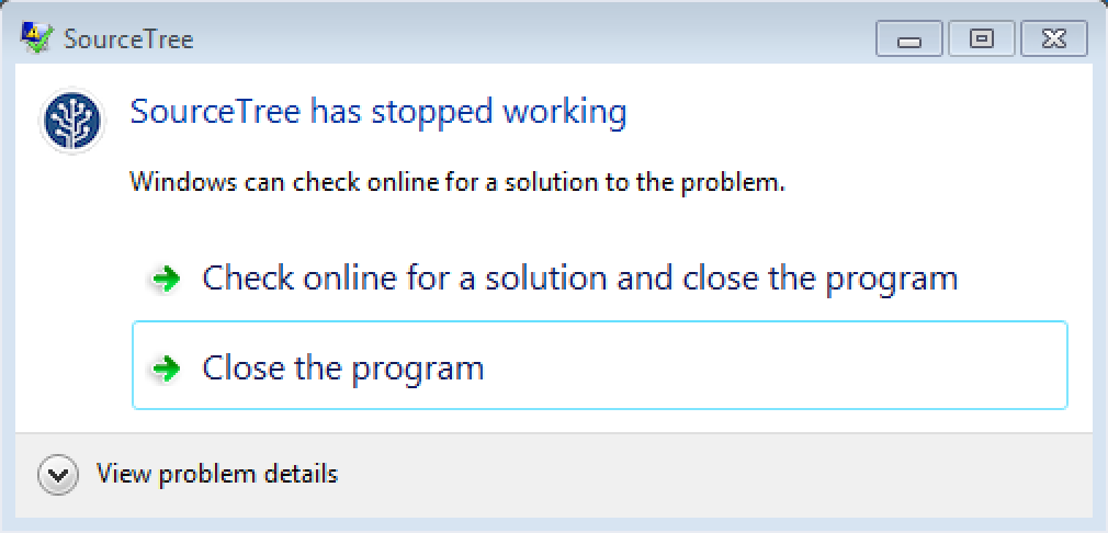

Problem
When attempting to start SourceTree, the following dialog is displayed with the message "SourceTree has stopped working", and the application does not start:
