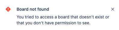

If the user doesn't have access, it will get the pop-up below:
The error when the user can't access the board
