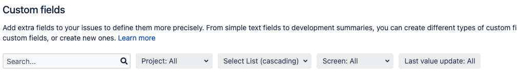

  2. Filter for custom fields that are of type cascading.
    1. Go to ⚙ > Issues.
    2. Click on Custom Fields.
    3. Select Type as "Select List (cascading)".
    4. Select Project with the affected project.

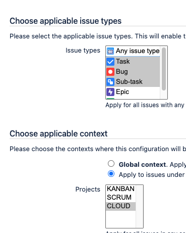

    5. Audit all the custom fields you see in this list, making sure there are only valid ussue types.
      Issue types and contexts
  3. Verify that all the issue types in use on the project from the SQL query above are selected in the applicable issue types in the context.
