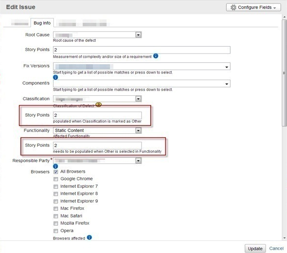

When seeing a Screen in JIRA, a different Field is displayed rather than the one configured. You can see in the example below that the Story Points field is being displayed three times in the screen:

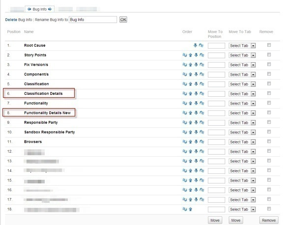

However, looking on the Screen configured for this Project/Issue Type, the original fields are correctly configured, and the Story Points is only appearing once:
