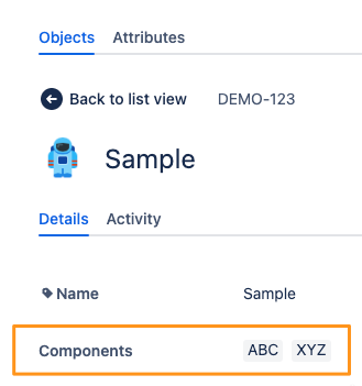

  1. In this example, we are accessing an Object with a Select attribute type called Components holding the values ABC and XYZ:
