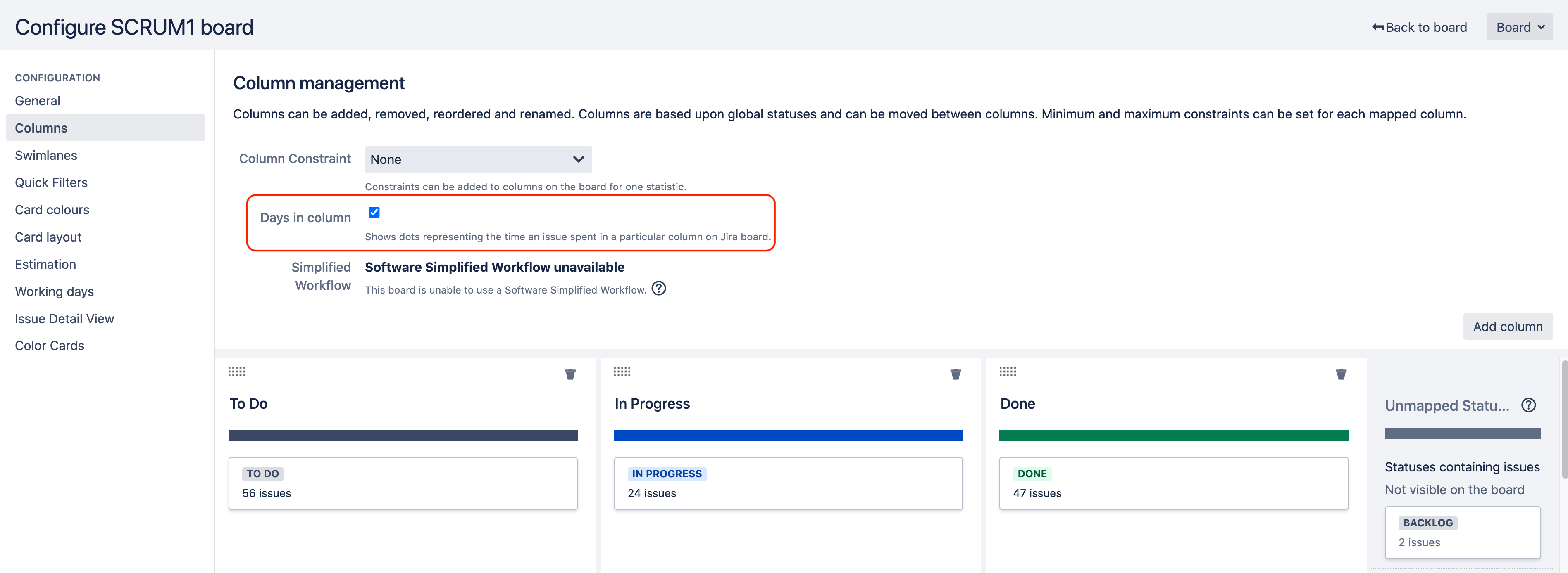

This KB article lists a few scenarios where an incorrect number of dots is displayed in the Sprint Cards, when the option Days in column is enabled for a board in Board > Configuration > Columns:

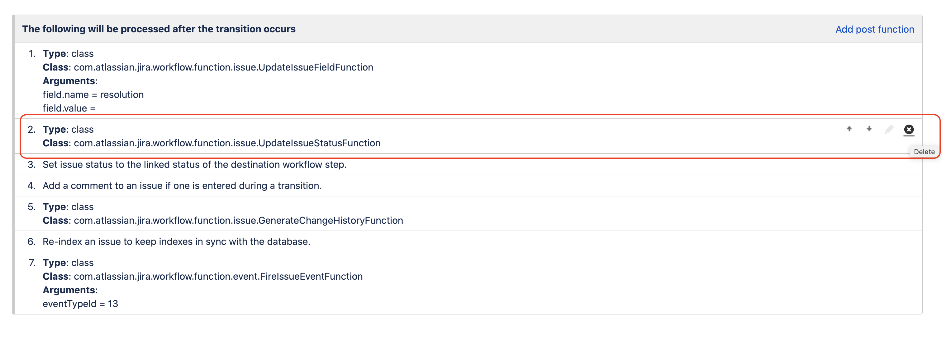

Take a look at the post-functions associated to the transition going into the status in the column where you see that the number of dots is incorrect, and check if you see both post-functions listed below:
  • 1 post function showing a class name:
    1 2 Type: class Class: com.atlassian.jira.workflow.function.issue.UpdateIssueStatusFunction
  • 1 post function showing a "user friendly" name:
    1 Set issue status to the linked status of the destination workflow step.
If both post-functions are present in the same transition, then this KB article is relevant, and you can proceed to the sections Root Cause for Scenario 1 and Solution for Scenario 1.
Note that both post-functions are referring to the exact same post-function. The only difference is that, in one case, its class name is showing, or in the other case, its user-friendly name is showing.

The transition contains duplicate post-functions that set the status twice during the transition, which can be seen in the issue history, and which causes some issue history corruption:
Because the data related to the issue history is corrupted, the issue card in the Sprint view shows an incorrect number of dots.

Remove the duplicate post-function from the transition by removing the one that shows the class name com.atlassian.jira.workflow.function.issue.UpdateIssueStatusFunction, as shown in the screenshot below:
Make sure to publish the workflow after you make this change.
