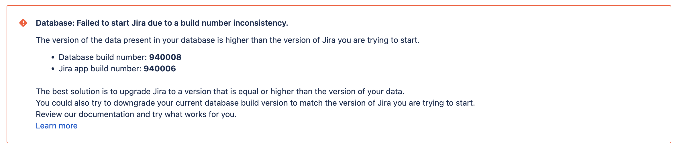

When the first node started is in a lower version than seen in the Jira database, although the process will not stop, this node will not get available for the cluster.
Example from lab: The Jira database is on version 940008 (9.4.8), the first started node is on version 9.4.6.
  • From the UI, connecting direct to the lower version node, we observe a message as below:
  • From the node in version 9.4.6 logs we have:
1 2 3 4 5 6 7 8 9 10 11 main ERROR [c.a.jira.health.HealthChecks] Failed to start Jira due to a build number inconsistency. ... main ERROR [c.a.jira.health.HealthChecks] The version of the data present in your database is higher than the version of Jira you are trying to start. - Database build number: 940008 - Jira app build number: 940006 The best solution is to upgrade Jira to a version that is equal or higher than the version of your data. You could also try to downgrade your current database build version to match the version of Jira you are trying to start. Review our documentation and try what works for you. ... main ERROR [c.a.jira.startup.DefaultJiraLauncher] JIRA has failed to start because of the following errors: [(Event: Level = (EventLevel: fatal) , Key = (EventType: database) , Desc = Failed to start Jira due to a build number inconsistency. , Exception = The version of the data present in your database is higher than the version of Jira you are trying to start.<br/><ul><li>Database build number: <strong>940008</strong></li><li>Jira app build number: <strong>940006</strong></li></ul><br/>The best solution is to upgrade Jira to a version that is equal or higher than the version of your data.<br/>You could also try to downgrade your current database build version to match the version of Jira you are trying to start.<br/>Review our documentation and try what works for you.<br/>)]

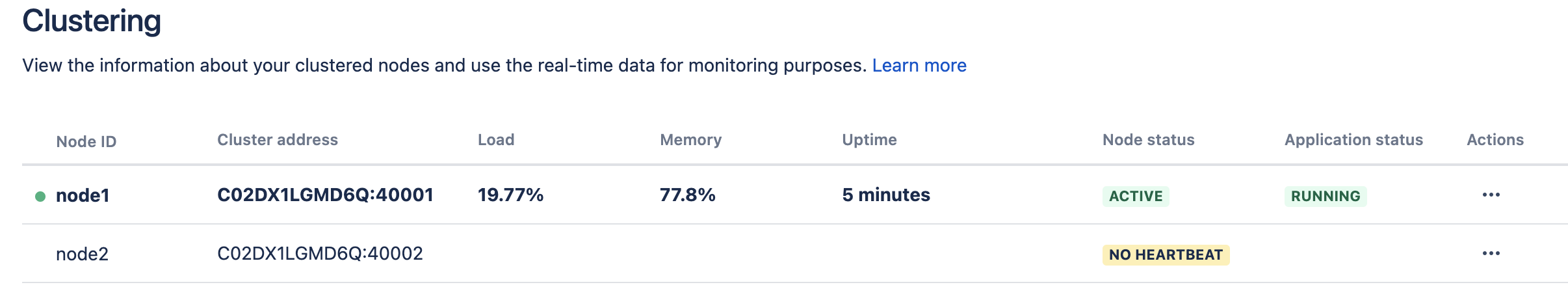

If the first node started is in the same version as seen in the database it will proceed with a clean start, however if the remaining node is in a different version this last will not become available: the process will not stop, and when the last node is in higher version it will not attempt to upgrade the Jira database.
Example from lab: The Jira database is on version 940006 (9.4.6), the first started node is on version 9.6.4, and the second on version 9.4.8.
  • From the UI we have for the first node that node 2 (9.4.8) attempted to connect, but is without a heartbeat.
  • From the node 2 (9.4.8) logs we have:
1 2 3 4 5 6 7 8 9 10 11 12 13 main WARN [c.a.jira.startup.ClusterNodeVersionCheckLauncher] Node with different build number ("node1" with version 9.4.6/940006) from this node (9.4.8/940008) detected, delaying start-up for up to 300 seconds. ... main ERROR [c.a.jira.startup.LauncherContextListener] Unable to start JIRA. java.lang.RuntimeException: Refusing to start up this node. Node with different build number ("node1" with version 9.4.6/940006) from this node (9.4.8/940008) detected The following nodes run a different version of JIRA and are preventing startup of this node: Node ID Build Number Version ------------------------------------------------------------------- node1 940006 9.4.6 These nodes must be stopped or removed from the cluster before this node will start.
