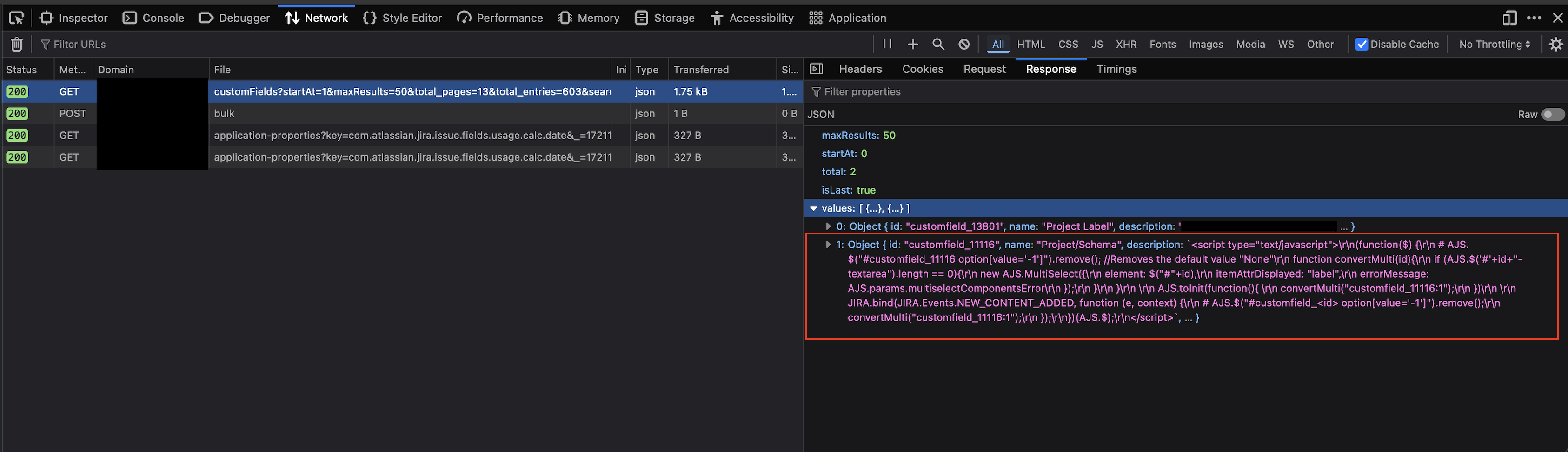

When searching for a custom field in the search field under Jira Administration > Issues > Custom Fields, the web page becomes unresponsive, causing it to get stuck as shown in the image below.

  • Follow Generating HAR files and analyzing web requests to generate HAR file while reproducing the issue
  • HAR file can be loaded to browser for analysis by accessing the browser’s developer tools, navigate to the "Network" tab and upload the HAR file collected earlier
  • Look for the HTTP GET request made to the Jira REST API endpoint:
    GET https://<jira-baseurl>/rest/api/2/customFields
    This request retrieves the details of custom fields configured in your Jira instance.
  • Select the identified HTTP GET request in the developer tools and click on the "Response" tab.
  • Locate the section related to the 'Problematic' custom field in the response. This will typically involve expanding the values section of the response.
  • The response should display detailed information about each custom field, including the customfield ID, name, description, and other metadata.
  • Pay special attention to the Description field of the custom field. It contains custom JavaScript code, which indicates a customization that is not part of the vanilla (out-of-the-box) Jira instance.
  • Once you identified the "Problematic" Custom Field, take note of:
    • its ID (the ID is the XXXXX number located after "customfield_" in customfield_XXXXX) - It will be useful for the Solution 1
    • its name - It will be useful for the Solution 2
