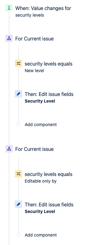

3) Create an automation rule as follows:
Note: Here "New level" and "Editable only by" are security levels.
We are using the "Field value changed" trigger for the custom field. Based on the value set, we are updating the security level of the issue. With the above rule, when the value of the custom field is changed from the roadmap plan and the changes are approved, the security level of the issue is changed. Since we are not adding the custom field to the jira issue edit/create screen, users should not be able to change the field value as well.
