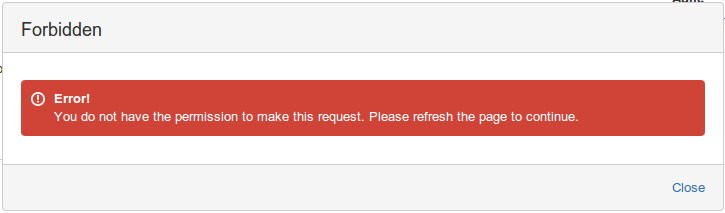

Users receive a 'Forbidden - You do not have the permission to make this request.' error message

After restoring a backup or updating the JIRA license to a higher tier, the error below is displayed while navigating on JIRA or updating issues:
Although the error is displayed, the actions are completed successfully.
