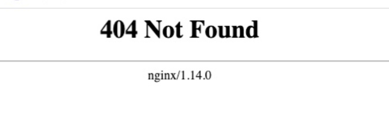

Whenever you try to access JIRA through the proxy URL, you get the following generic 404 error:
You will also see the following "permission denied" errors in the nginx logs:
