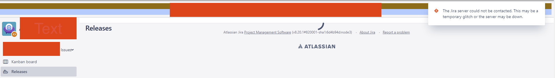

Users get The Jira server could not be contacted. This may be a temporary glitch or the server may be down error when they try to access the Releases page.

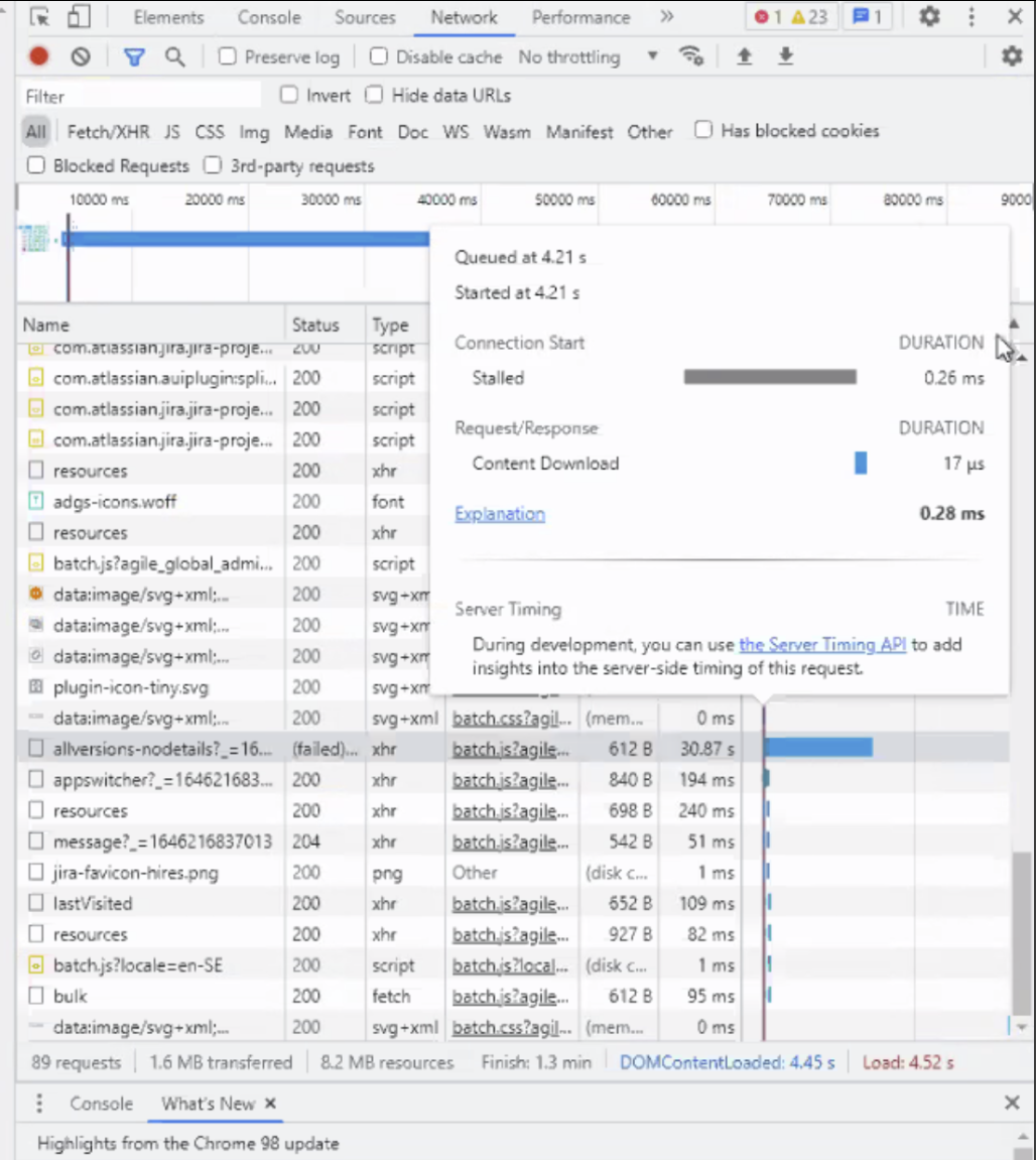

The request is done successfully on the server-side but the following appears in the console logs when a HAR file is generated:
batch.js?agile_global_admin_condition=true&jag=true&jaguser=true&locale=en-SE:5257 GET https://xxxxxxxx/rest/projects/1.0/project/PROJECT_KEY/release/allversions-nodetails?_=1646216837011 net::ERR_CONNECTION_RESET 200

  • HAR file indicates that the transaction runs for a long time (in this example, it's more than 30 seconds)
  • Check if the proxy timeout is shorter than the server response time or not
  • If possible, bypass the proxy, log in to one of the Jira nodes over node IP and Tomcat connector port which is defined in the server.xml, and see if you can access the related page.
