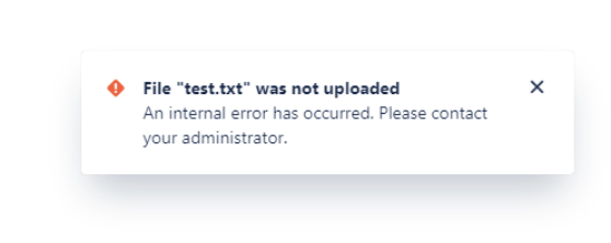

When trying to upload attachments to any issue in Jira, the upload fails and users see a "attachment failed" message in the upper-right corner of the screen.
