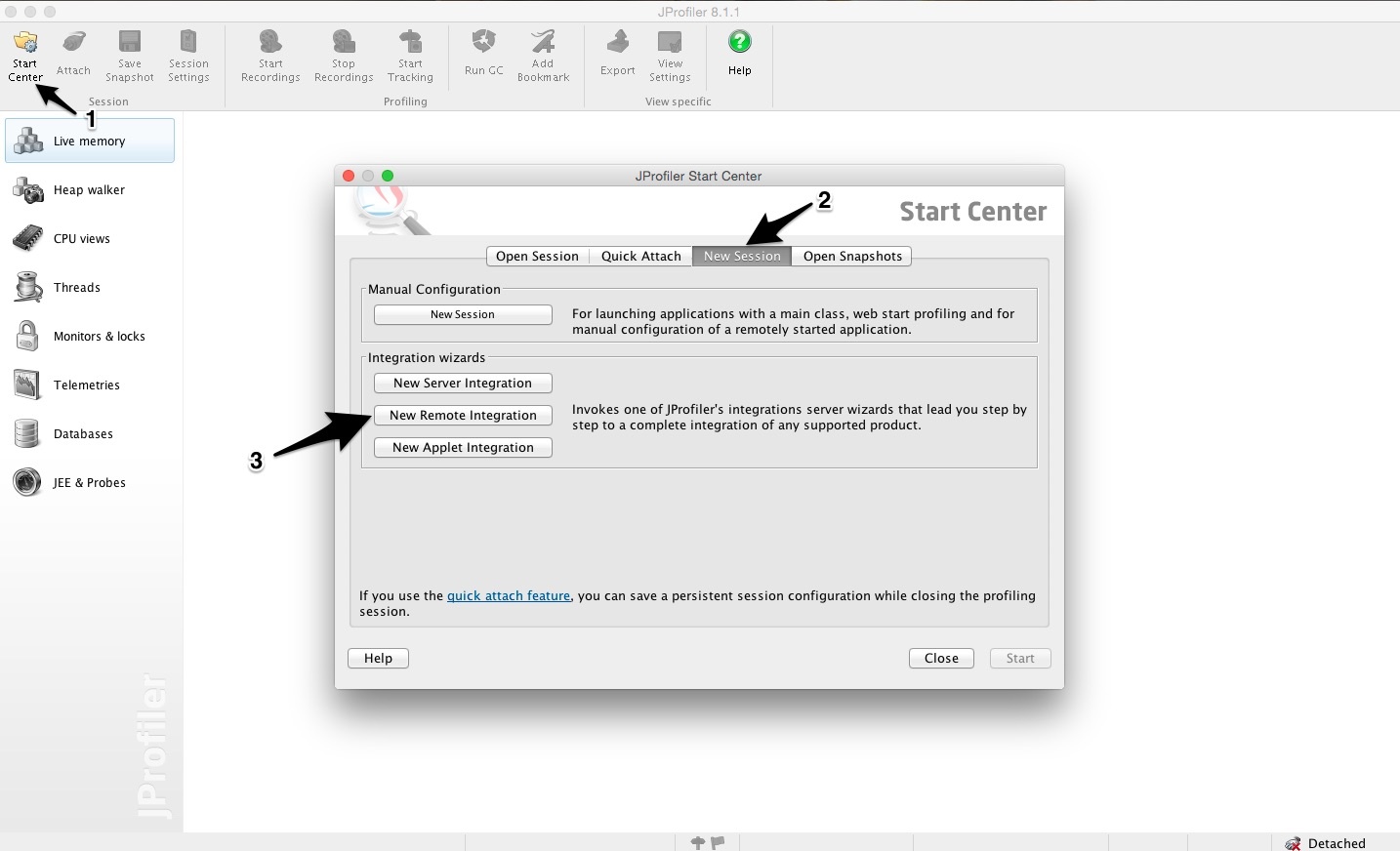

  2. Run through the Start Center to setup the JIRA application instance so it can be connected to:

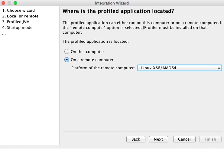

  3. Select 'New Remote Integration' (the instance is on a separate server to where jProfiler is installed) and follow the instructions in the wizard.

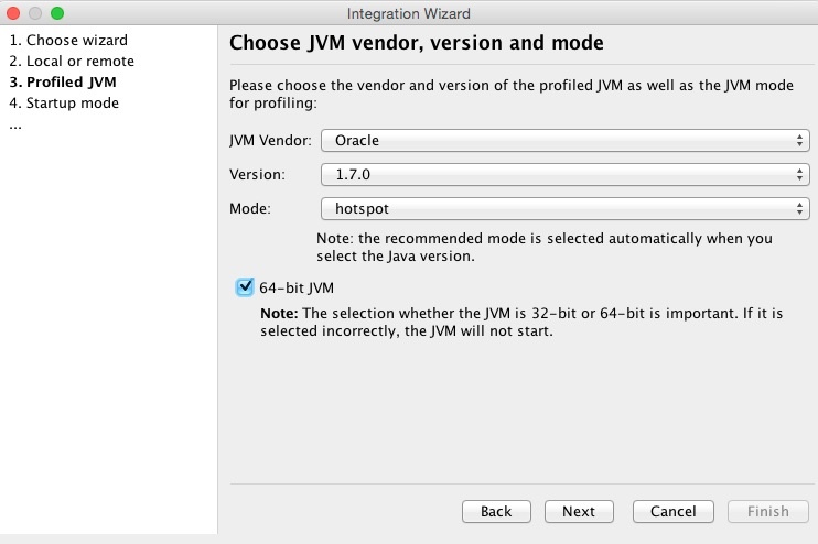

  4. Pick the correct version and architecture of the target operating system (OS):
  5. Ensure the correct version of the JVM is selected:

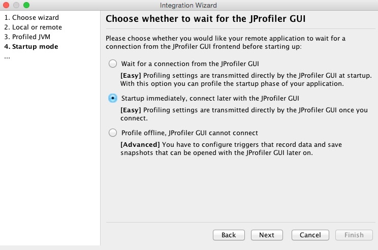

  6. Select the 'Startup immediately, connect later with jProfiler GUI' option:

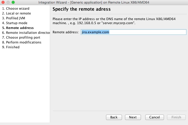

  7. Enter the Server FQDN (or hostname) of the JIRA application instance - in this example replace jira.example.com with whatever that is:

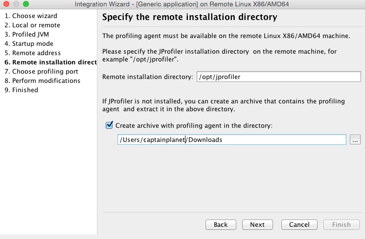

  8. Specify the location of the jProfiler agent on the target OS. This is required so jProfiler can bind to the target application. If this is the first time the profiling agent has been installed, select the 'Create archive' tickbox and specify a location on the OS where jProfiler is running (not the target OS).
  9. Confirm the download, if downloading the archive.
  10. Copy the archive file and unpack it in the 'Remote installation directory'. For example copy /Users/captainplanet/Downloads/jprofiler_agent_linux-x64.tar.gz and untar it into /opt/jprofiler.

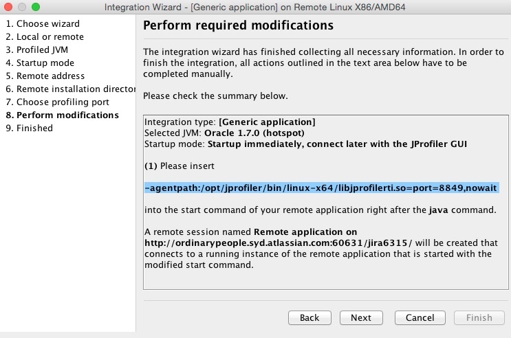

  12. Copy/paste the highlighted JVM arguments from the below page into the appropriate configuration as per Setting Properties and Options on Startup.

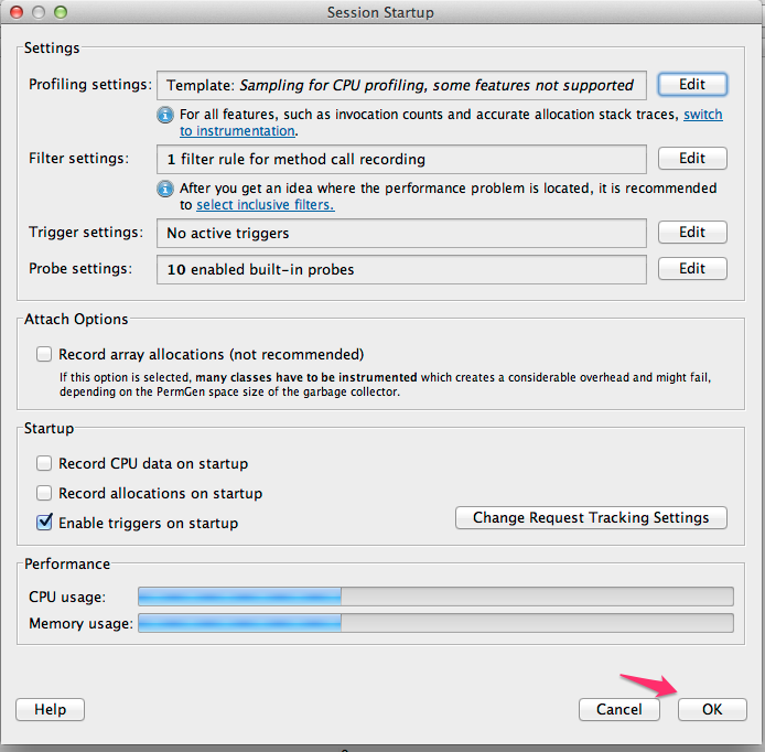

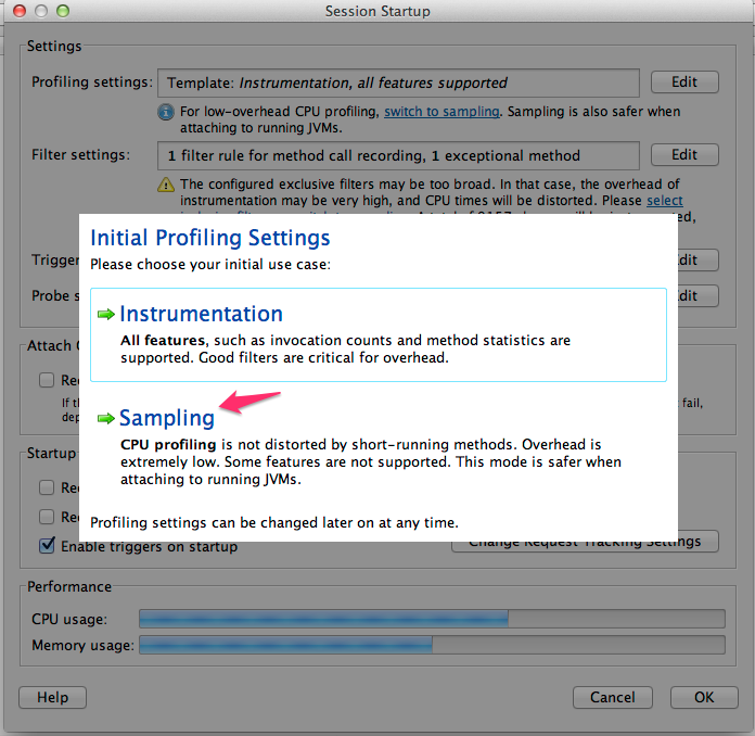

  2. Select Sampling, as below:
  3. And then press OK, no other settings need to be done. There will be some minor transformations of classes, please wait for this to finish.

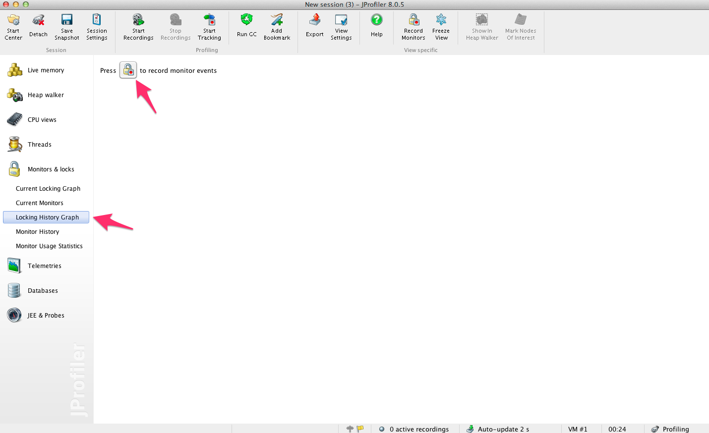

  6. (Optional): Monitors & Locks recordings can be enabled as per the below, this isn't always needed though. Done in Monitors & Locks > Locking History Graph > Record.

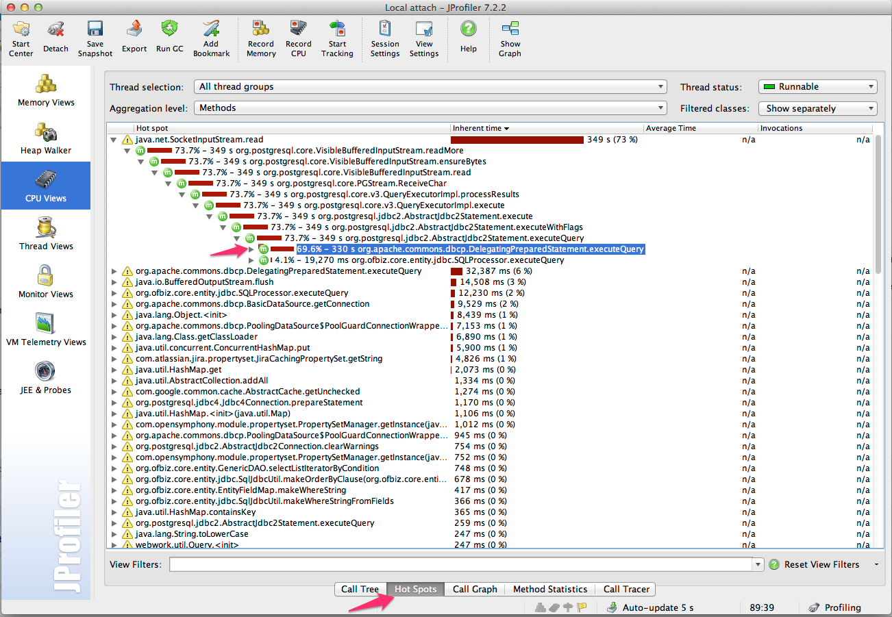

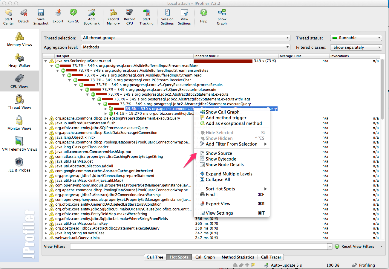

  1. Change to the Hot Spots mode and expand the top method (this will be the method that's taking the longest), for example
  2. Expanding the methods will provide a breakdown of what exactly is taking the longest for the JVM to respond (this is the virtual machine that powers JIRA).
  3. If jProfiler has been connected to an IDE (for example, IntelliJ), you can right-click on the method and Show Source:

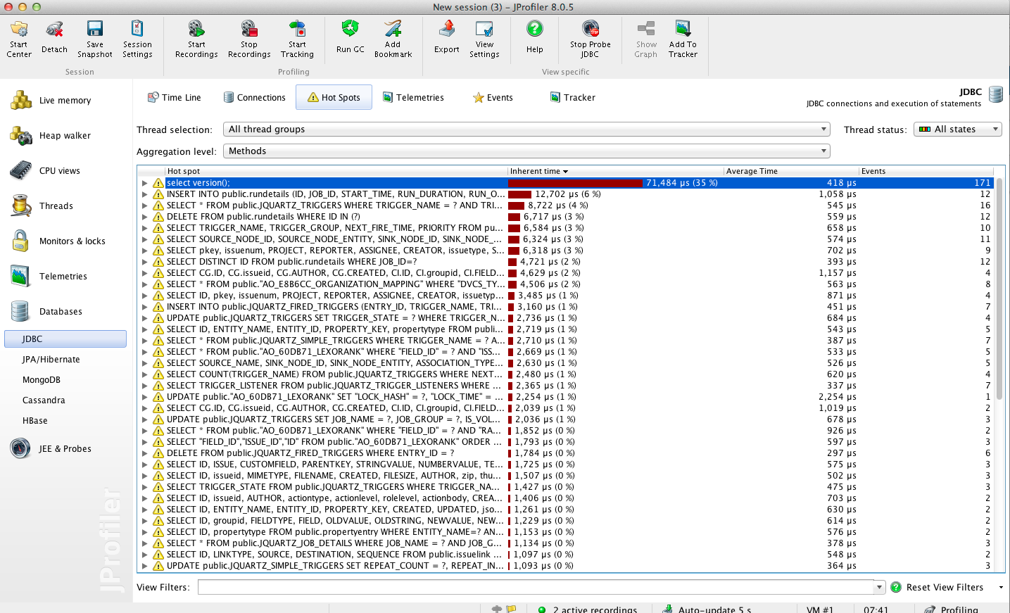

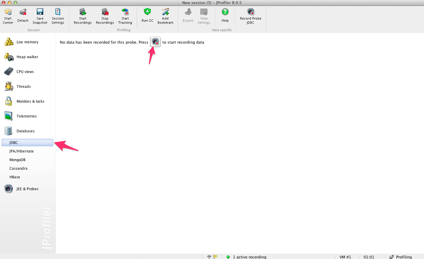

Browse to Databases > JDBC > Hot Spots and review the SQL to see which queries are taking the longest. For example:
