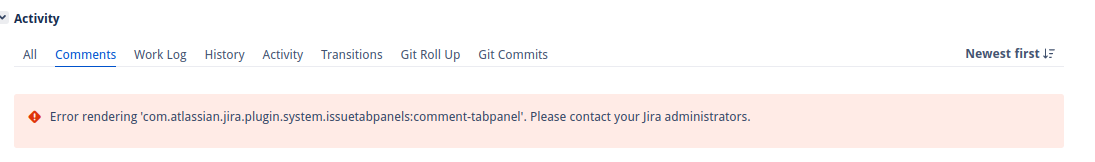

When viewing an issue and checking the comments, they will not load and follow error will be present;
Preventing users from seeing any comments added to the affected issue. Additionally, the following error will appear in the atlassian-jira.log:
