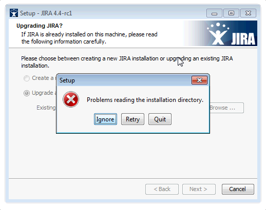

  1. When upgrading JIRA 4.3 to JIRA 4.4 via the upgrade JIRA 4.4 upgrade capable installer, the following error message is encountered - "Problems reading the installation directory."
  2. Upon selecting 'Retry', the same error is displayed
  3. Upon selecting 'Ignore', the installer continues until it checks to see if JIRA has been shutdown
  4. The installer prematurely exits with no errors displayed in Windows and a NullPointerException displayed in Linux.
The following is a screenshot from the Windows installer:
