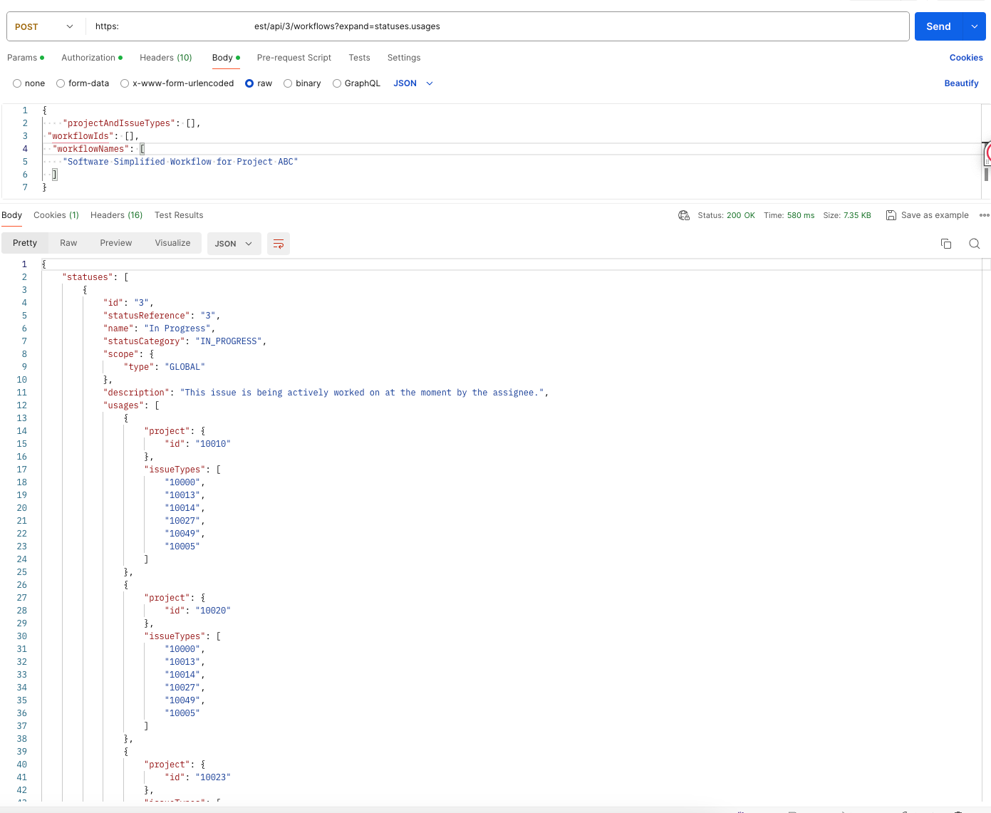

  1. Fetch the workflow you want to change using bulk get workflows. This will return the current state and the current version of the workflow which are mandatory among other fields for the update call.
    • TIP: use the expand property to fetch the status names - /rest/api/3/workflows?expand=statuses.usages. Without this property status details don't include their names but ids as with names statuses are quickly identified.
    • do note that you need to specify either of "projectAndIssueTypes": [], "workflowIds": [], "workflowNames": [] parameters for this request. As an example, the workflowNames can be used which is returned via the Get workflows paginated.
      1 2 3 4 5 6 7 { "projectAndIssueTypes": [], "workflowIds": [], "workflowNames": [ "NAME_OF_THE_WORKFLOW" ] }
  2. Here is the result:

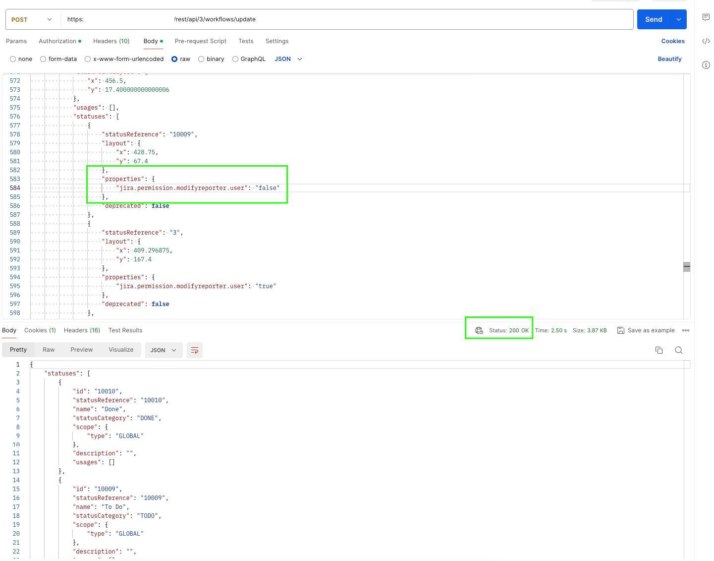

  3. Copy the response body and add it as a payload to the next request in p.5.
  4. Then we can manipulate the workflow with the desired change in the payload for the bulk update.
    • In this example we are updating a property of a status. The previous call returned the statusReferences and in their properties parameter, we can add a change.
    • From true:
      1 2 3 4 5 6 7 8 9 10 11 12 13 14 ...... "statuses": [ { "statusReference": "10009", "layout": { "x": 428.75, "y": 67.4 }, "properties": { "jira.permission.modifyreporter.user": "true" }, "deprecated": false }, .....
    • To false:
      1 2 3 4 5 6 7 8 9 10 11 12 13 14 ...... "statuses": [ { "statusReference": "10009", "layout": { "x": 428.75, "y": 67.4 }, "properties": { "jira.permission.modifyreporter.user": "false" }, "deprecated": false }, .....
  5. Finally, run the update using the original endpoint workflow update post by using the response from step 1 as payload here.
