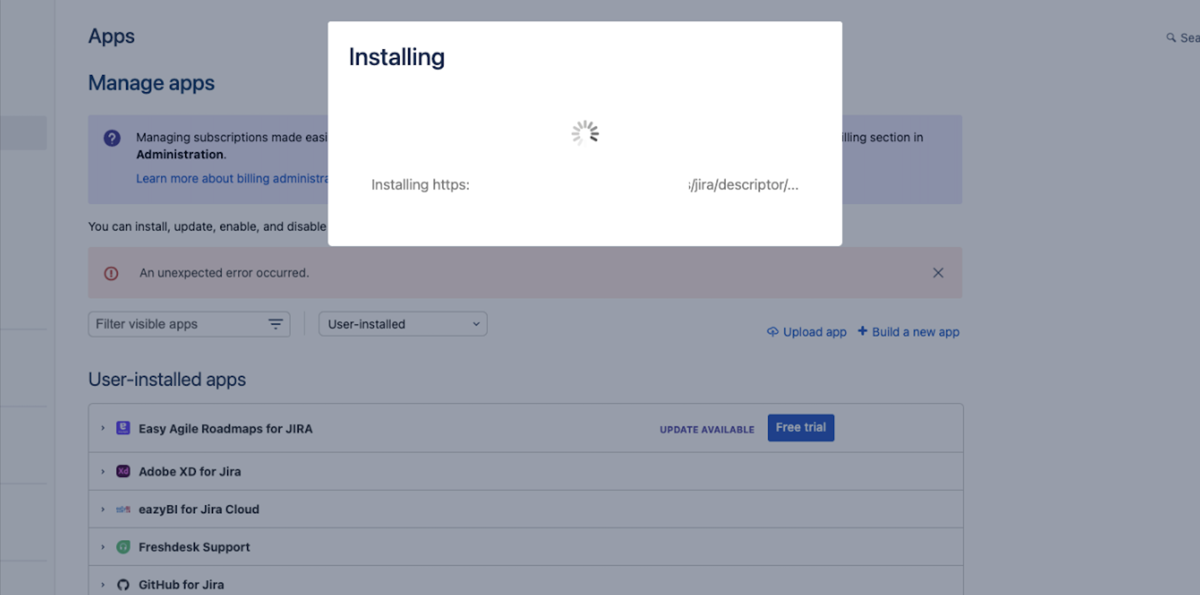

1) Installation fails with the below error:
An unexpected error occurred.

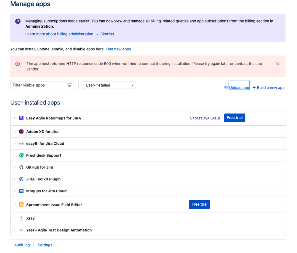

2) You may see the below Error, but the APP will get installed anyway
The App host returned HTTP Response code 500 when we tried to contact it during installation. Please try again later or contact the App Vendor.

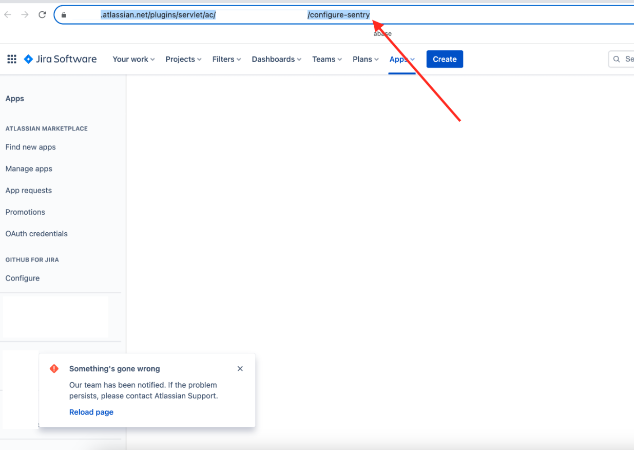

  • If Yes, then Click on Get Started / Configure button. After a bit of loading, you may see the below error.
  • Open browser developer tools: "Browser Settings" > "More Tools" > "Developer Tools" (for Chrome)
  • Generate Network and Console trace logs by reloading the above page: Generating HAR files and analysing web requests
  • Go to the Console logs and check if you see the below error:
Refused to display 'https://sentry.infra.paylead.fr/' in a frame because it set 'X-Frame-Options' to 'deny'.
