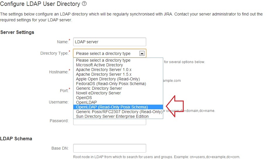

You are trying to set up an LDAP connector in JIRA, connecting to an OpenLDAP/FedoraDS server. After the sync is completed, the users and groups have been imported into JIRA successfully, but the group memberships are not there, e.g. the groups contain no users, and all users are not members in their respective groups.
The following appears in the atlassian-jira.log:
1 2 3 4 5 6 7 [ldap.mapper.entity.LDAPGroupAttributesMapper] The following record does not have a groupname: {ou=ou: Groups, objectclass=objectClass: organizationalUnit, top} [atlassian.crowd.directory.DbCachingRemoteDirectory] failed synchronisation complete in [ 75ms ] [atlassian.crowd.directory.DbCachingDirectoryPoller] Error occurred while refreshing the cache for directory [ 10000 ]. com.atlassian.crowd.exception.OperationFailedException: org.springframework.ldap.UncategorizedLdapException: Unable to find the groupname of the principal. at com.atlassian.crowd.directory.SpringLDAPConnector.searchEntitiesWithRequestControls(SpringLDAPConnector.java:416)

You are configuring an LDAP type which is incompatible with the LDAP schema, e.g. you should use theOpenLDAP (Read-only Posix Schema) directory type instead of OpenLDAP.

For the First Causes:
Use theOpenLDAP (Read-only Posix Schema) directory type in JIRA, instead of OpenLDAP.
For the Second Causes:
Use the Generic Directory Server directory type in JIRA, instead of FedoraDS (Read-only Posix Schema).
