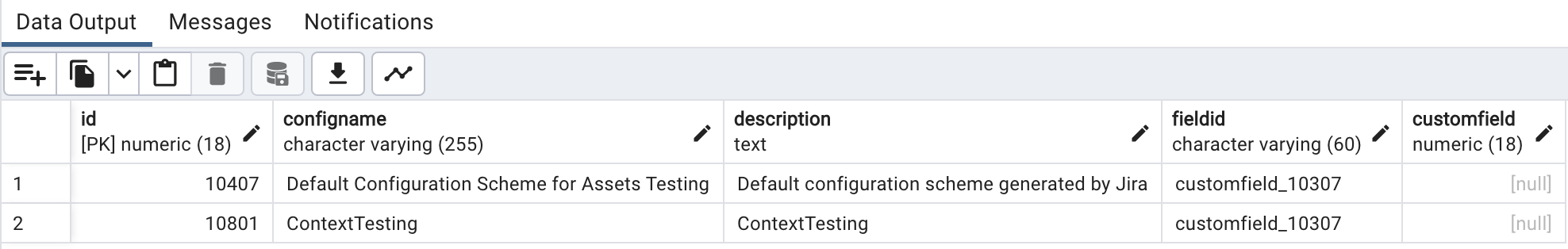

  • Run the below query to validate the number of contexts associated with the problematic customfield and focus on the problematic context which can't be deleted. In our use-case for validation, we have 'customfield_XXXXX' with 2 contexts.
    SELECT id from fieldconfigscheme WHERE fieldid = 'customfield_XXXXX'; --> XXXXX is the value of customfield id. 10407 10801

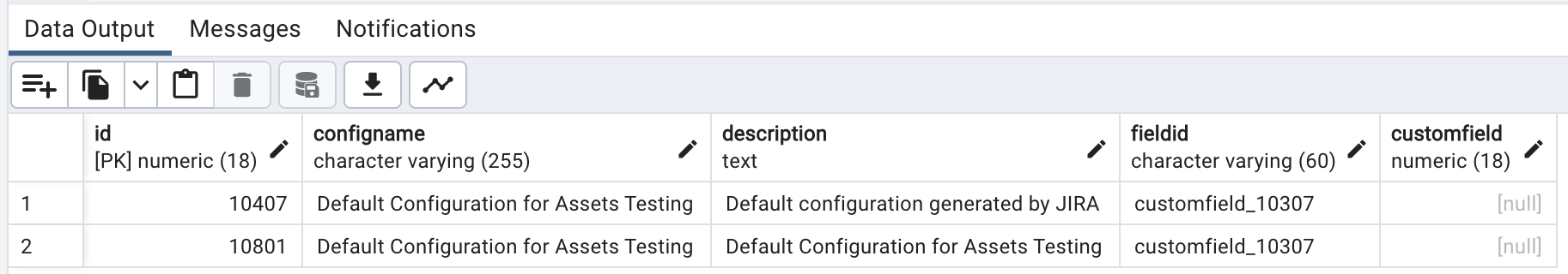

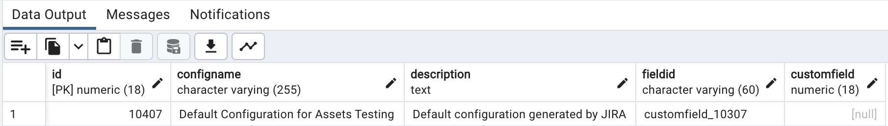

  • While there is missing entry in the 'fieldconfiguration' table for the problematic context, we need to manually create an entry with missing 'id' returned from results of above query. In our local testing, it's 10801 which is missing.
    SELECT id from fieldconfiguration where fieldid = 'customfield_XXXXX'; 10407
  • While updating the 'fieldconfiguration' table to populate the missing 'id' which is 10801, we can use existing 'configname' and 'description' values to update the data in the tables, the crucial information is the missing id. Once we update the table, it should look like below.

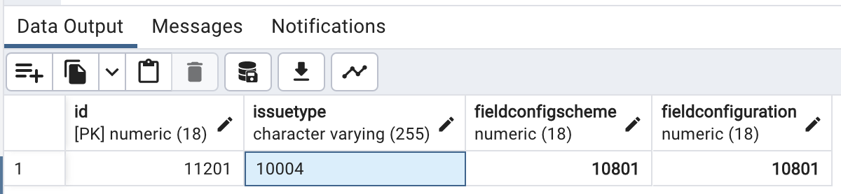

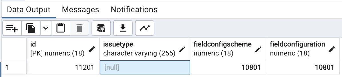

  • Now validate the entries from 'fieldconfigschemeissuetype' to map an issue-type to the problematic context which is missing. Check the issue-type matched to other context of same customfield, in this case context id is 10407.
    SELECT * from fieldconfigschemeissuetype where fieldconfigscheme = '<impacted_id>'; SELECT * from fieldconfigschemeissuetype where fieldconfigscheme = '10801'; --> In our testing impacted fieldconfigscheme id is 10801.
  • Observe the missing value for 'issuetype' in below screenshots, we need to update one of the issuetype id's to fix this gap. We used the id '10004' used in other context which is 'Bug'.
