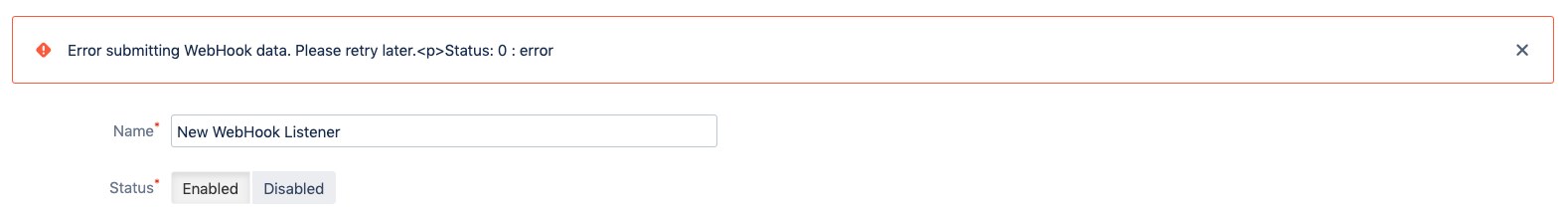

Trying to edit or delete a Jira Webhook configuration results in the following error in the UI: <p>Status: 0 : error
