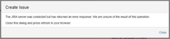

Users are unable to create any issue, when the "Create" issue button is clicked the browser returns below error:

  • atlassian-jira.log is throwing below XSRF check errors
2016-03-24 11:41:39,639 http-nio-8080-exec-9 WARN username 701x48328x3 1sx07jj 10.50.8.252,127.0.0.1 /rest/webResources/1.0/resources [c.a.p.r.c.security.jersey.XsrfResourceFilter] Additional XSRF checks failed for request: http://jiradev.domain.com/rest/webResources/1.0/resources , origin: null , referrer: https://jiradev.domain.com/secure/Dashboard.jspa , credentials in request: true , allowed via CORS: false
Cause
Tomcat is not "aware" of the reverse proxy due to "proxyName" and "proxyPort" are not specified in the connector in server.xml. As a result the browser request is blocked, due to REST API not receiving the expected hostname/port from the origin header value.
